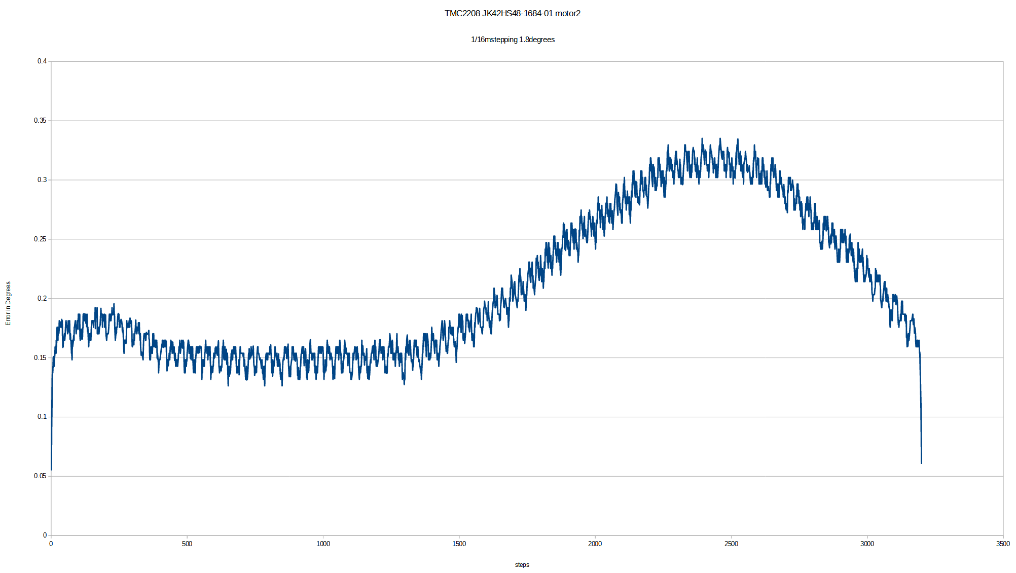

      idea came from here: https://forum.duet3d.com/topic/20582/stepper-precision-5
      I borrowed some 16bit encoder from a client to do a test, long story short @mendenmh suggested a solution with python library and it worked to talk to the encoder
      encoder and motor are attached with painters tape enforced with zip ties
      rpi (pin12 step, pin13 direction) with a hat that has 74hct14 to up the signals to 5V and tmc2208 on header (default factory config with ms0 and ms1 connected to 5v)

              first test with e3d's "Super Whopper Motor" MOTECH MT-1705HS200AE
              if you look at the code after the step there is delay(1), 1 second delay, I initially started with delay(0.1) so 100ms delay and I seen ton of vibrations ?!?!? even with microstepping, very slow movement, I see vibrations. If you look at the code, I read encoder 10 times, I read it very slow (19200bps), and I see vibrations after 100ms of delay after step before reading?!?!?!?

              It's not "that terrible" but cmon, 100ms delay, ZERO LOAD, vibrations... not expected....
              When I up the delay to 1sec the motor "calms down" and there are no vibrations, example:

                  In my experience doing this kind of thing, you need to use a bellows coupling between the motor and encoder to get reading that will be useful for your purpose.
                  Painters tape and zip ties will introduce all kinds of strange angle changes between those two mechanical parts that do not represent the actual position of the stepper motor shaft.

                      Try gathering data for one-turn slowly clockwise and one turn slowly counterclockwise.
                      If the data is within your error expectations, you have a good system.
                      I predict (and I may well be wrong) when you compare those two datasets you will see great variation from one to another and that tells you that your measurements are as accurate as the difference between those to readings.

                        already done 🙂 the data is spot on, +-0.0 🙂 comparing directions

                          What's the angular resolution if your encoder?

                            @alankilian 360/65535 degrees

                              Well, all I can say is you are getting results that do not match with my experience in such situations.
                              Being able to rotate 180-degrees and repeatable read within 0.005-degree is some kind of black magic indeed. You are a master.

                                😄 we'll see how it goes on the "bigger sample" I just let it go 400 steps forwards and 400 steps backwards and store all the data and spit out differences... would be much easier if I knew python (darn thing don't even have proper arrays) ... as for 180degrees back forth that one I did not test ... I just let it run 3200 steps forward and 3200 steps backwards and compared two greps ... let's see how the aaaaaaaaaaaaaaaaaaaaaaaaaaaaaaaaaaaaaaaaaaaaaaaa sh%$#%^# forgot to pipe it into file 😞 .. need to run it again ... brb

                                      I'm having a little trouble analyzing your data.
                                      It looks like you are taking 3201 samples every revolution when I look at the .zip file you uploaded.
                                      I didn't take a look at the Python code since I'm also not a Python expert.
                                      Take a look at when your encoder flips over to it's minimum count and see that there seem to be ( to my eyes) 3201 samples between them.
                                      That makes it a little difficult to analyze.
                                      I'll take a look at your next data set after you upload it.

                                        @alankilian going forward then backward and recording all steps was awesome suggestion ... data is ugly 😞
                                          the "multiturn" file is stepping for a while (whole night) going forward. encoder goes up to 65535 and then to 0 (it is absolute encoder) so it allow multiturn but records only positions inside one revolution
                                          the "single turn" have 2 reasons to figure out it's full turn, one is to read the "similar" (20 less difference) position from the first one it reads when it start, and second reason is if it makes 400*32 steps (I assume 1/32 microstepping .9 degree motor ) .. first run it made 3199 steps in second 3200 steps. Motor is 1.8 degree and microstepping is 1/16 so 3200 steps is ok.
                                          Now, you see "more" data, that's cause I do: Step, read encoder 10 times (output all 10), calc average of those 10 and display average value (add them all together and divide by 10). So for every step there is 11 rows in the txt file...
