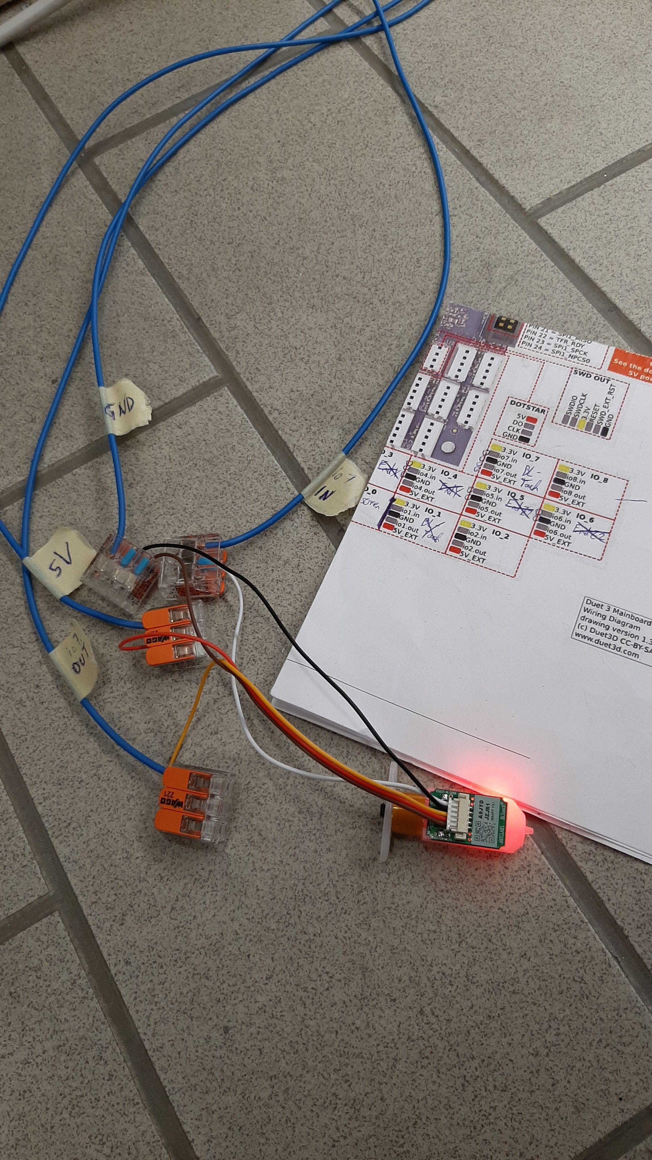

Hi.
I am currently configuring a custom 3D printer and so far have overcome all of the other problems and am now at my wits end regarding my BL-Touch...-
->Problem description:
When turning on my machine, the Probe does its automatical restract-and-deploy test 2 times, like it should. Afterwards, it turns red (constant, not blinking). M401 and M402 do what the should do. But when I call G30 OR G29 to home, the Pin won't deploy on its own, so if I wouldnt hit the Emergency-Stop, the hotend would crash down into the bed (since Z-axis is moving).
I would be extremely grateful for your help as I am under time pressure; and since this is the last thing to adjust before a first testprint, I am quite unnerved.
Looking forward to your answers
EDIT:
I forgot to mention quite a few things:
I am using Duet 3 MB6HC and the reprapfirmware-online-configtoolAlso I did the wiring according to this guide on duet dozuki:
so my black (endstopground) and brown (powerground) cable are connected immediatly after the bl touch (not quite sure if this could give me a problem, thats why im mentioning it here)EDIT END
It's very strange that M401 and M402 work to deploy and retract but not when G30 and G29 are sent.

Here is a picture of my (temporary) wiring of the BL (connected to Duet 3 MB6HC, IO-Port 7). Is this wrong? I may be dumb.
Another important thing: if I first manually deploy the probe with M280 P0 S10 and then home, it works andthe z-axis goes up as soon as the bl touch touches the surface (but the pin does not retract here). So, when I command a G29 AFTER that, it will say: "error: zprobe not triggered during probing" or something like that. So in conclusion, the first homing works after deploying the pin with M280 P0 S10 and after that, it doesnt work at all.

@chris-0, it may not help, but you should remove the ^ from this line:
M558 P9 C"^io7.in" H7 F120 T600 ; set Z probe type to bltouch and the dive height + speeds
The pullup resistor never needs to be enabled when using Duet 3 IOx.IN pins, and doing so worsens the noise margin.
Also, please send M558 without parameters, and check that the values it reports are the ones you set in config.g.

TELNET is disableddeployprobe and retractprobe files are single line M280 P0 S10 and M280 P0 S90 accordingly. Probe does react to these commands.
@commie said in BL-Touch V3.1 not automatically deploying:

When you send G30 the pin should deploy and touching the pin should cause it to trigger. If that doesn't happen, check the white wire. That's the trigger signal wire.
@phaedrux
G30 doesn't deploy the probe. All wiring was checked. Sensor itself is 100% working taken off another printer. -

@commie In that case it definitely seems like the trigger signal wire isn't making a connection.
Instead of letting it crash, try the testing method here: https://duet3d.dozuki.com/Wiki/Test_and_calibrate_the_Z_probe
Yeah I tried that too putting something in probe's way, same result (ie no result). Wire integrity was checked with multimeter, all good. There's 5V on red and 3.4V on white wires. Just in case here's my connection pic attached.

@commie You could try moving the white wire from the zprobe input to the z_stop pin and changing the pinname in M558 as well.
It's a clone probe on a clone duet, so sometimes things don't work as expected?
