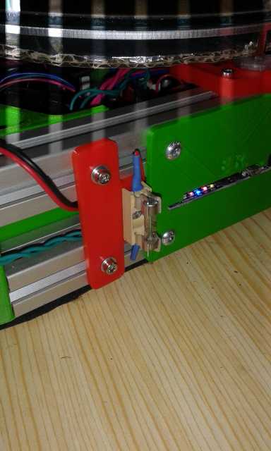

                                    hi thanks found it it has popped and i solidered onto the (E0 vssa) pin and the paneldue ground pin
                                    i left a long wire soldered onto a slow blow 0.25a fuse which ill replace with a fuse holder and small glass fuse 0.25a next week which is why i left a long wire on for now
                                    before i plug this in and connect is this correct also will this over load the negative trace if i plug a paneldue in ?

                                        Just a rant but I really hate how these Chinese thermistors come with their leads sleeved in paper-thin PTFE. One reason…tighten that screw more than a little and you've just pinched right though. I imagine in some scenarios this could even lead to a potential fire.
                                        Another reason is PTFE isn't safe to use at temperatures as high as some hot-ends are capable of operating. I've seen several "all metal" hot ends come equipped this way. And look for type-K thermocouples on Amazon, they're all sleeved in PTFE. It's like making a kitchen pan out of plastic.....why even bother?
                                        @Cap: If I were you I'd get some high-temperature fiberglass sleeving and use that to insulate the thermistor leads. Also, looking at that fuse fix makes me cringe. There's a strong potential for those long fuse leads to pick up noise and interfere with your temperature readings. I also doubt that big glass fuse is even remotely capable acting fast enough to protect the processor in the event of another short. If you're in the US, I stock replacement VSSA fuses and could properly repair your board for a reasonable cost and turn it around the next day.

                                          im in the uk and i now have fiberglass sleeving and new thermistors heading to me from e3d
                                          as for the wires they go straight down throw the case printed in abs and dont run along the board it self so hopefull they should be fine but yes tomorrow ill go to me local hardware store and change the fuse to as small glass 0.25a fuse inside a fuse holder
