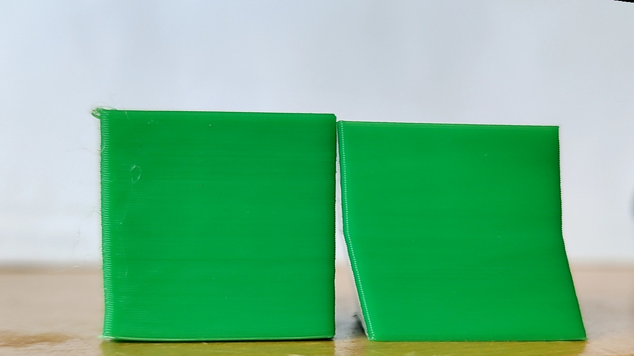

@t3p3tony I think it might be related to y direction travel between objects. With two simple 20x20x20 cubes displaced 40mm in the y direction but aligned in the x direction, I get a pronounced (18deg) slope in the - y direction on both cubes . Printing the same two cubes aligned in y but displaced in x seems to give straight sides.

@dc42 I have some more to add to the theory
Both cubes are printed with 3.4b3.
The right hollow cube is printed in vase mode.
The left hollow cube was printed as a single wall. This one had a z hop setting of 1mm
I am currently printing the same gcode with no z hop and it is not exhibiting the same leaning in Y.

With a 20mm cube and a 20x20x10high cube offset in the y direction printed together, the 20mm cube (on the right) looks like this
The left cube for comparison printed with no y offset. You can see that the lean reduces after 10mm, but interestingly a smaller lean is still seen. Havent tried a 45deg rotated cube yet. -
Thanks to everyone who has helped us to try to track this down. @chrishamm has managed to reduce one of your leaning prints to a pair of 2 moves that leaves one of the carriages 2 microsteps away from the correct position. I expect to be able to track down the problem now.
