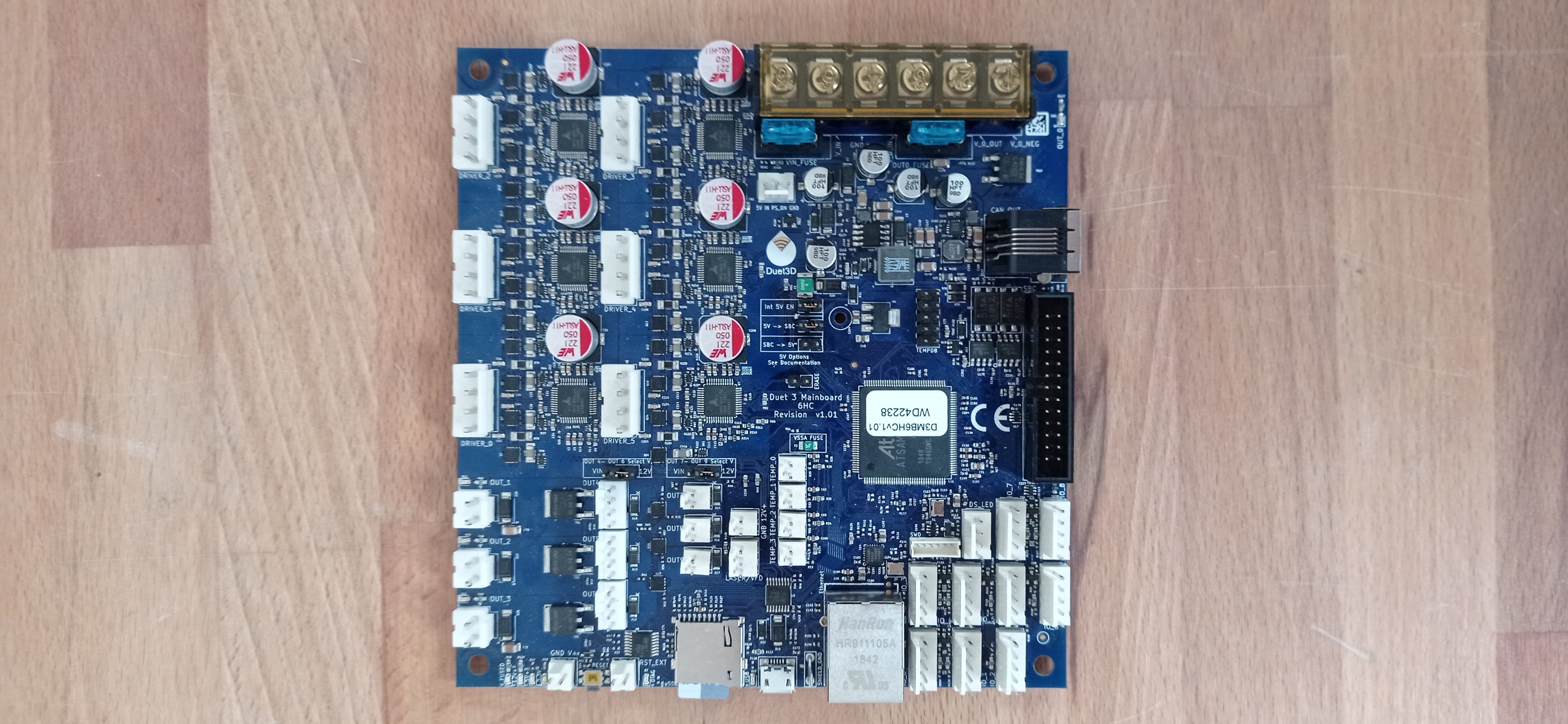

      I have a Duet3 6HC for my Printer. Used a MKS Sbase 1.3 with external drivers before.
      I use Nema17 motors in X (2 parallel) and Y (4 parallel) and 2 Nema 34 (parallel) in Z axis.
      The printer is pretty big, thats why I need the Nema 34.
      Everything is working except the movement of the motors.
      Problem 1: X and Y Axis
      The Driver 0.1 is working fine. I can plug the X or Y axis on this Driver and they work how they should.
      So I assume my wiring of the X/Y motors is correct.
      When I decline the motor to a different driver and connect them to it and want to home/move I get the message:
      Driver 0.X warning: phase A may be disconnected, phase B may be disconnected
      This appears at all drivers I decline in the config.
      Endstops are plugged and working. Extruder motor is working as well.
      Problem 2: Z Axis
      It doesnt matter on which driver I decline the Z Axis I always get this message:
      Warning: Driver 0.2 warning: phase A short to ground, phase B short to ground, phase B may be disconnected

        can you add high res photos of your board -- back and front, as well as the connectors for the motors?

              Yes I tried to use only one motor for the X Axis on the other drivers, still only working on driver 0.1.
              I bought the duet some month ago from a german reseller CR3D. Use the duet since one week or so.
              When I use the Z motors on the working Driver 0.1 i get this message:
              Warning: Driver 0.1 warning: phase A short to Vin, phase B may be disconnected
              3.5.2022, 09:48:57 Error: Driver 0.1 error: phase A short to Vin
              Changed the steps, acceleration etc. to the suitable values for the Z axis.
              Is it even possible to run the Nema 34 with the board or do I need a extension board or something?
              Also thought about going back to the external drivers, so I will need the extension board anyway...
              Here are the pictures of the board:

                        droftarts administrators @Fabian Du
                        @fabian-du This may sound silly, but check that you are connecting the motor to the correct driver on the board. The order of the drivers on the board is not intuitive:
                        You may have assumed driver 0 is next to driver 3, eg:
                        top of PCB
                        edge of PCB Driver 0 Driver 3
                        Driver 1 Driver 4
                        Driver 2 Driver 5
                        But actually driver 2 is. This would explain why driver 1 (it's in the middle) and the extruder (driver 3) works (I think you said this works?), but driver 0 and 2 don't (they are swapped).

                        • Fabian Duundefined
                          Fabian Du @droftarts
                          @droftarts
                          yes the swapped drivers would´ve made sense.
                          But I understood the positioning right, as shown in the first picture.
                          My Z Axis with the Nema 34 motors now also works in parallel with the driver 0.1 (middle, outside of the board) with the same settings I use for X and Y.

                          Its still only the driver 0.1 which is working.
                          Tried to use the Z and Y Axis in driver 0.0 and 0.2 and vice versa.
                          Still the same error.
                          Since the motors are working with driver 0.1, my wiring should be right.
                          The config for all axes are also the same, so I´m pretty clueless what else I could try out.
                            Please send an email to warranty@duet3d.com and CC your reseller. Include a link to this forum thread and the details of your original purchase. You'll receive a reply with a form to fill out.
