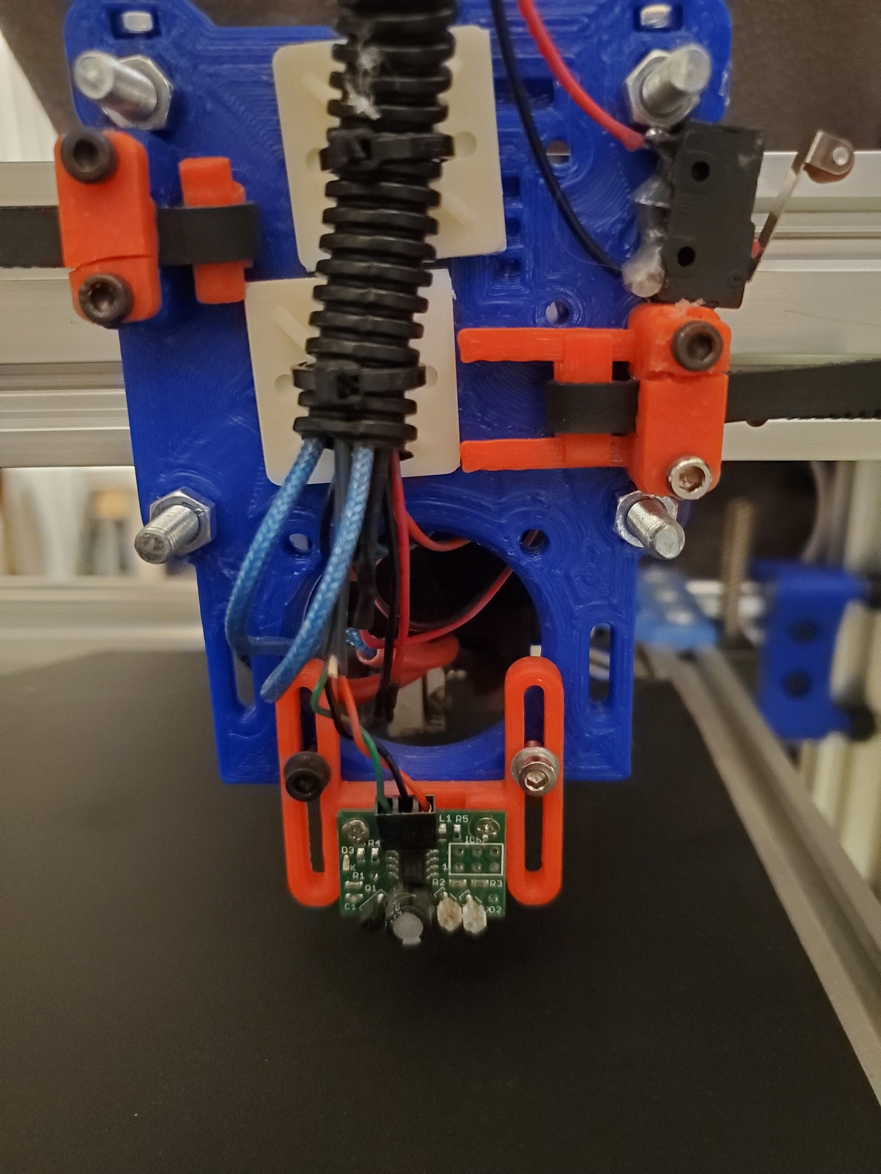

      Hello all, I have been fighting with trying to get this corexy calibrated to get a consistent first layer all day. It seems like one minute it's fine then the next its back out of skew.
      I'm running a core xy with 4 lead screws. I tried using g32 and now g29 both work fine one minute then one of the points wont trigger. ```

                        • Phaedrux
                          The offsets for the probe look suspect
                          G31 P500 X0 Y0 Z0.192
                          There is no X Y offset from the nozzle so the firmware doesn't know where the probe actually is. And the trigger height seems very small.
                          Have you gone through this yet? https://docs.duet3d.com/en/User_manual/Connecting_hardware/Z_probe_testing
                          ;Lead screw position
                          M671 X45:45:485:485Y45:424:424:45  s5
                          This command to define your lead screw positions may not be registering correctly because there is a missing space between the X and Y values and an extra space before the S.
                          Can you also post your homeall.g and config-override.g?
                          It would also be nice to see the results of sending M122 and M98 P"config.g" in the gcode console.
                          @trublu89 said in auto calibration:
                          it won't even crash it will just stop before reaching it.
                          Does this happen consistently in the space spot? Or totally randomly?
                          What is your bed surface? The IR probe can be sensitive to reflective or multicolor surfaces. You can try and eliminate this by putting a plane piece of white paper on your bed.
                          It would also be good to get some close up photos of the IR probe itself incase it is damaged in some way.
                          trublu89 1 Reply Last reply Reply Quote 1

                            I didn't realize there was a gap in my m671
                            That's how I came up with .192 homing to where the paper grabbed the nozzle and g92 z=0 g30 s1 to get the mean results.

                            It stops before reaching it in the rear right corner I adjusted the screw manually and eventually it will still do it.
                            The build surface I have is buildtak.

                                    @fcwilt this is g29 initially and then g29 with s1 at startup code right?
