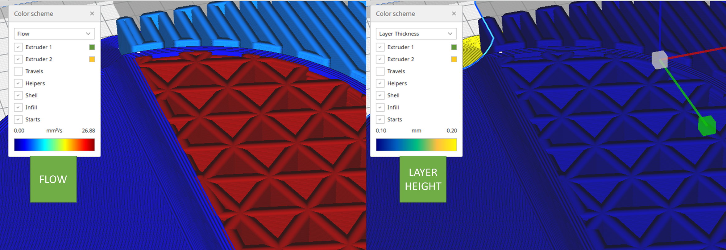

            • sebkritikelundefined
              sebkritikel
              A screenshot of the example I described above. Infill, inner walls, support in yellow, finer walls in green.

              • jens55undefined
                jens55 @sebkritikel
                @sebkritikel, thanks for that. I am using Cura 4.2 Master edition. It was the latest release available from that repository at the time but I will see if a newer version is available. I double checked and it definitely does not support different line widths. I might have to go to the official version instead. In any case. thanks for pointing me in the right direction.
                I will also have to check on layer height settings. The settings page you post shows the little 'linked' symbol to the left of the layer height suggesting that this can not be changed on a per extruder basis but your preview seems to show different layer heights. Anyway, something for me to explore!
                Also thanks to everybody else for pointing out that Prusa slicer supports this.
                  sebkritikel @jens55
                  @jens55 said in Slicer to allow different nozzle sizes in one print?:
                  You're using a relatively recent version of Cura, so you should be fine. For whats its worth, my example is using the 20220310 Cura Master build... In my first image, what happens when you do change the line widths for one of the other?
                  To understand the 'link' icon, one needs to be aware of what extruder is being used for the operation. In this case the layer height is the same for both extruders for the infill, but since only extruder 2 is printing infill, in effect its only affecting extruder 2, and not extruder 1.
                  I've been using Cura to print with various combinations of line widths/layer thicknesses in the same print for going on 5 years now, not sure why it doesn't seem to be cooperating for you.

                  • jens55undefined
                    jens55 @sebkritikel
                    @sebkritikel, looks like I was mistaken as far as line widths are concerned. Cura definitively supports different line widths for different extruders. It does however not seem to support different layer heights as such?
                    You indicated/circled 'infill layer thickness', that was the pointer I needed. Although I did notice this setting sometime in the past, somehow I didn't connect the dots in my mind. This gives me a way of speeding things up even though layer thickness itself is linked to all extruders.
                    Edit: I did take the opportunity to upgrade from 4.20.5 to 4.20.8
                    sebkritikelundefined 1 Reply Last reply Reply Quote 0
                      sebkritikel @jens55
                      @jens55 Hmm I think I'm seeing whats going on with the layer height. On my above example I have the infill and support printing at .4mm heights, but the Cura and Craftware preview show it as .1mm layer heights. If I incrementally move the layers upwards/downwards, it properly reflects that one infill/support layer is printed for every four outer line layers (since the infill and support is printed at 4x the layer height).
                      Getting the layer thickness preview to properly represent different thicknesses per line type sounds like a good enhancement request.
