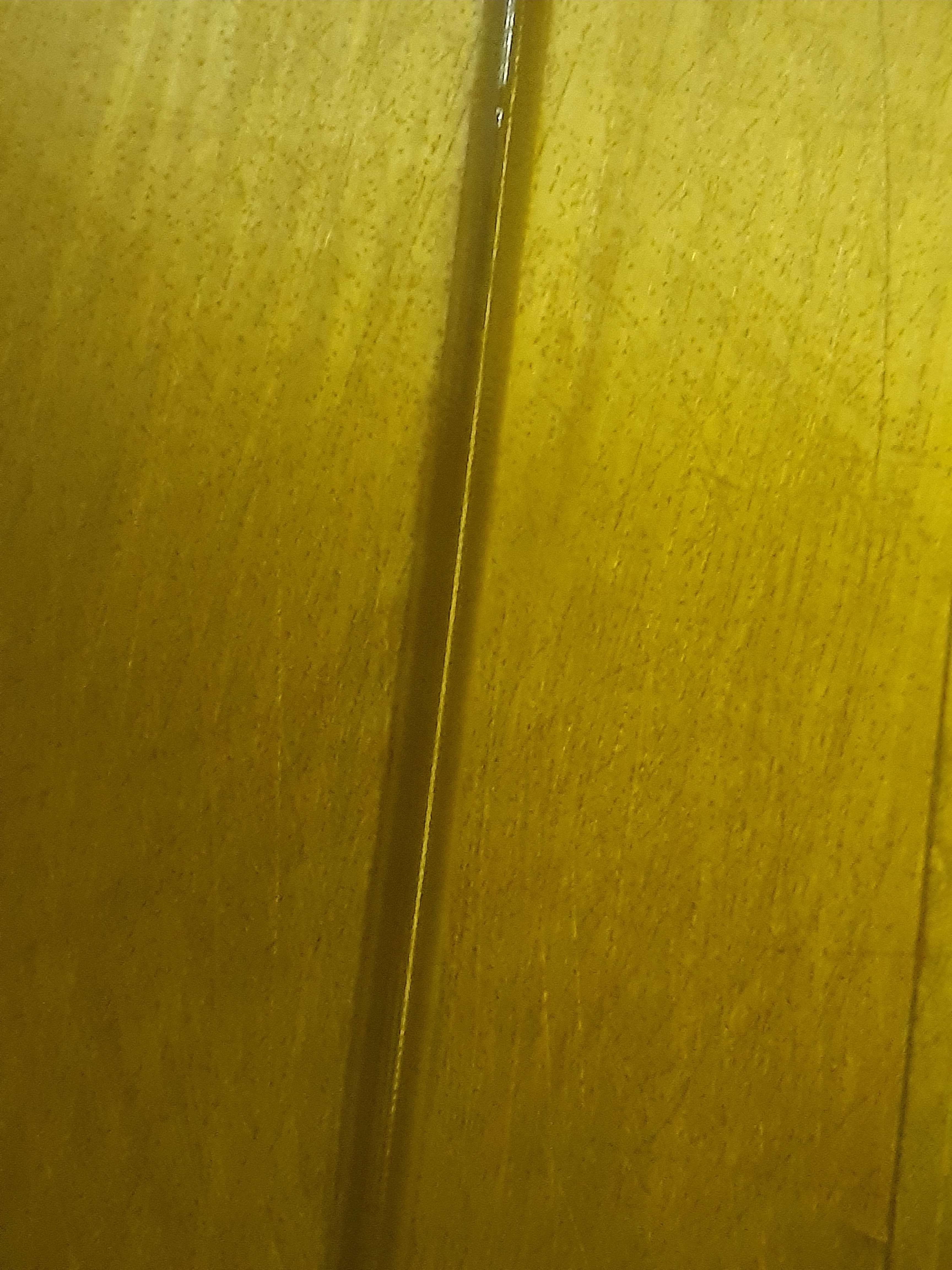

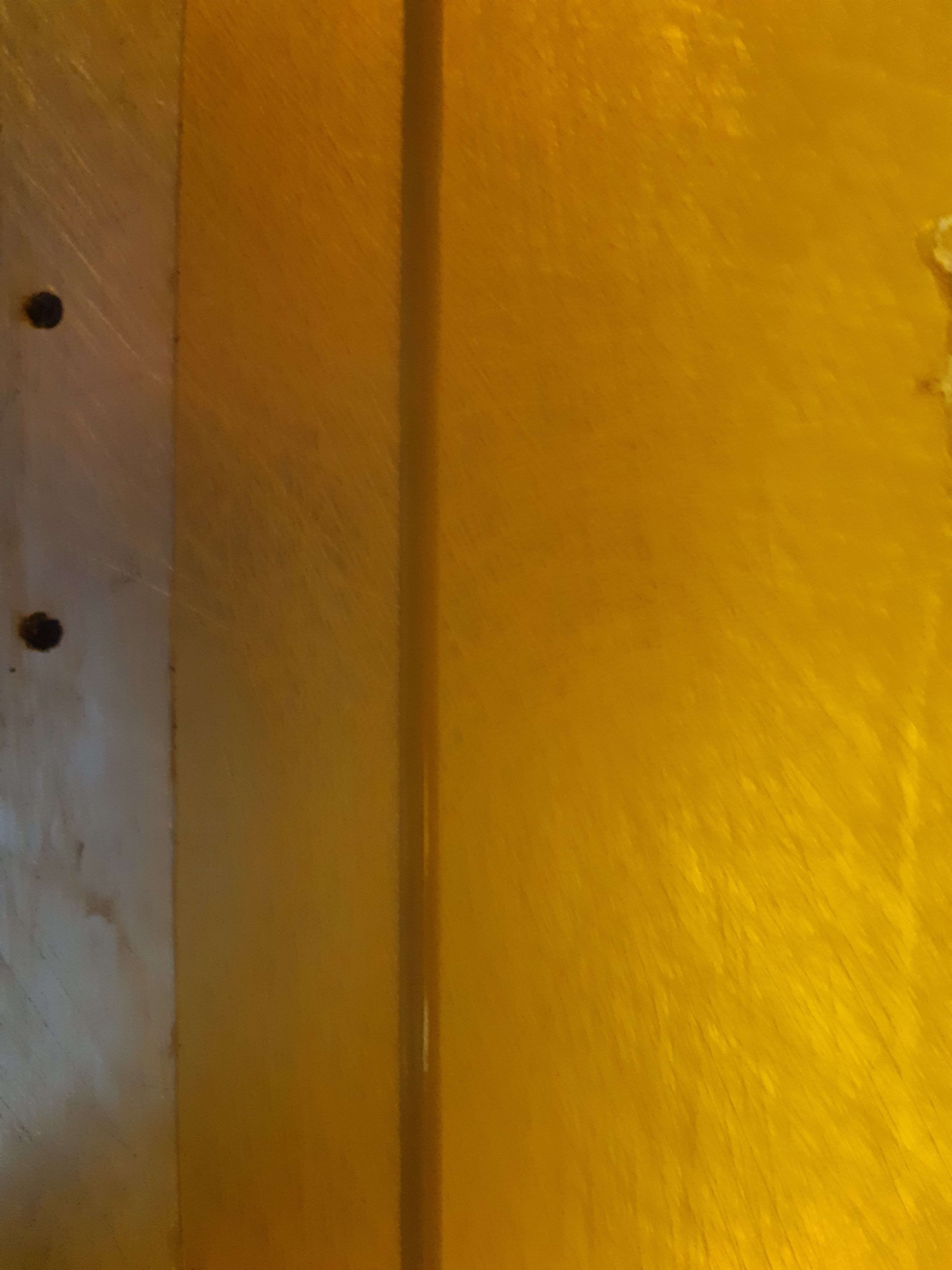

i have tried to get this first layer to print on a 320mm x 320mm bed . is a a square outline 300 x 300 0.3mm layer height 2.5mm wide ,
the result i get is that the left hand side doesnt stick to the bed and the right hand side has a great result. side by side pic below

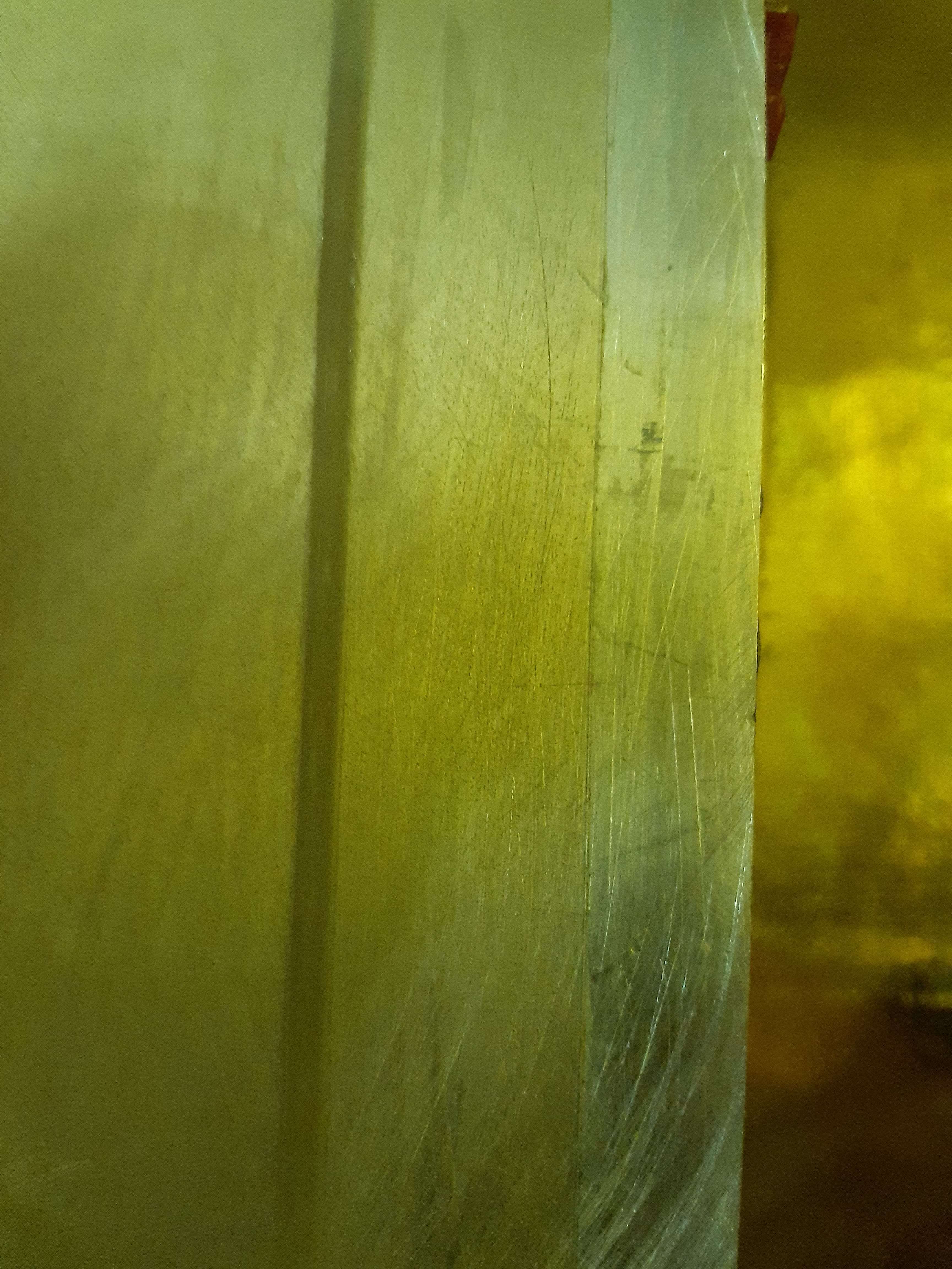

@moth4017 by the way my bed is very flat i put a straight edge on it last night and could not get a 0.05 mm feeler gauge under it

@Phaedrux hi i was using the 4 point mesh , but the difference in nozel height from the bed was bad enough for the left hand side not to stick to the bed and the right hand side had a nice squish , see photo
above -
