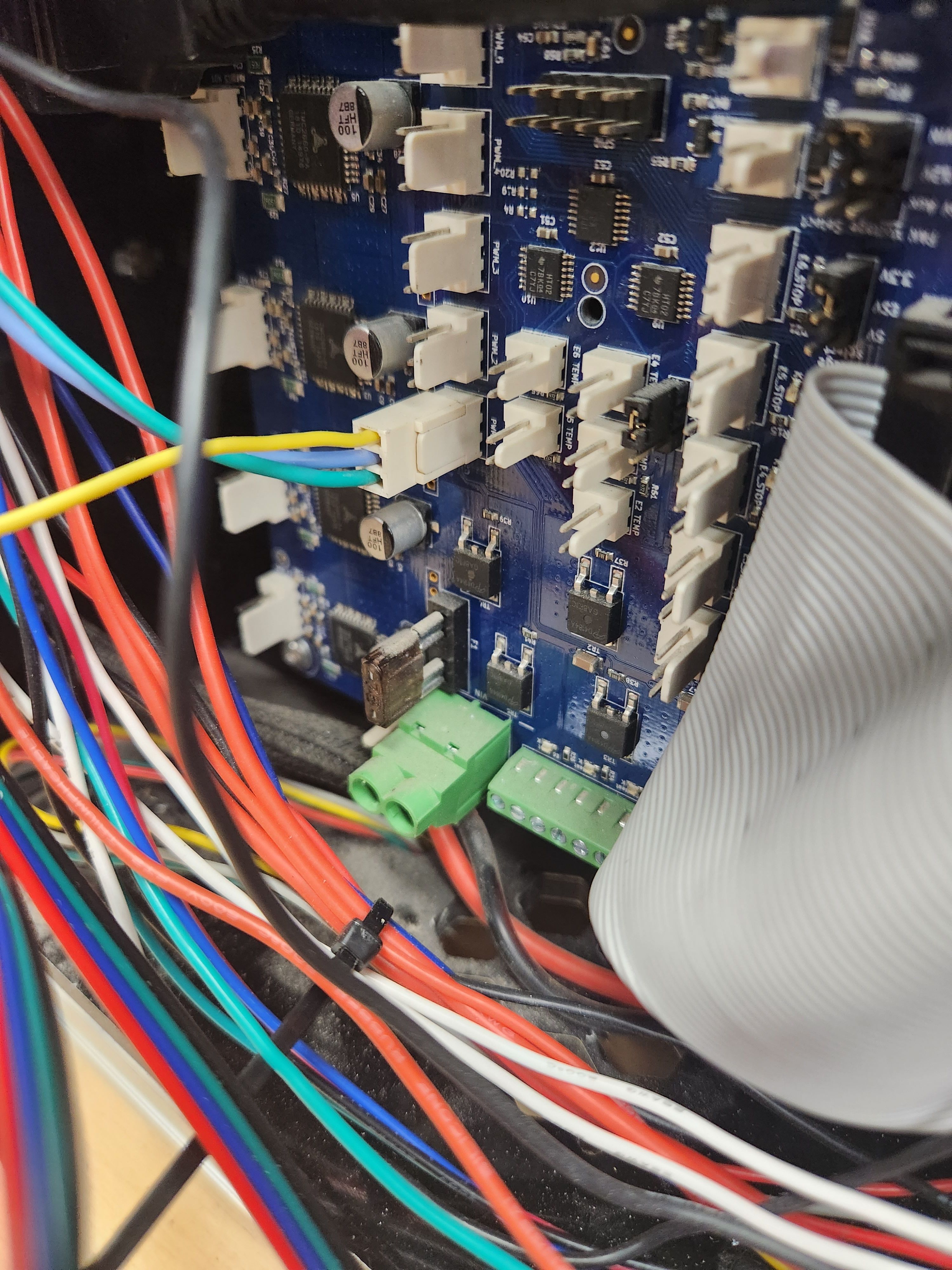

          CONNECTED TO THE PWM1 HEADER:
          GREEN WIRE CONNECTS TO THE BROWN WIRE ON THE BL TOUCH
          BLUE WIRE CINNECTS TO THE ORANGE WIRE ON THE BL TOUCH
          YELLOW WIRE CONNECTS TO THE YELLOW WIRE ON THE BL TOUCH
          CONNECTED TO Z BROBE HEADER:
          BLACK WIRE CONNECTS TOT THE BLACK WIRE ON THE BL TOUCH
          RED WIRE CONNECTS TO THE WHITE WIRE ON THE BL TOUCH
          THIRD POSITION IS BLANK

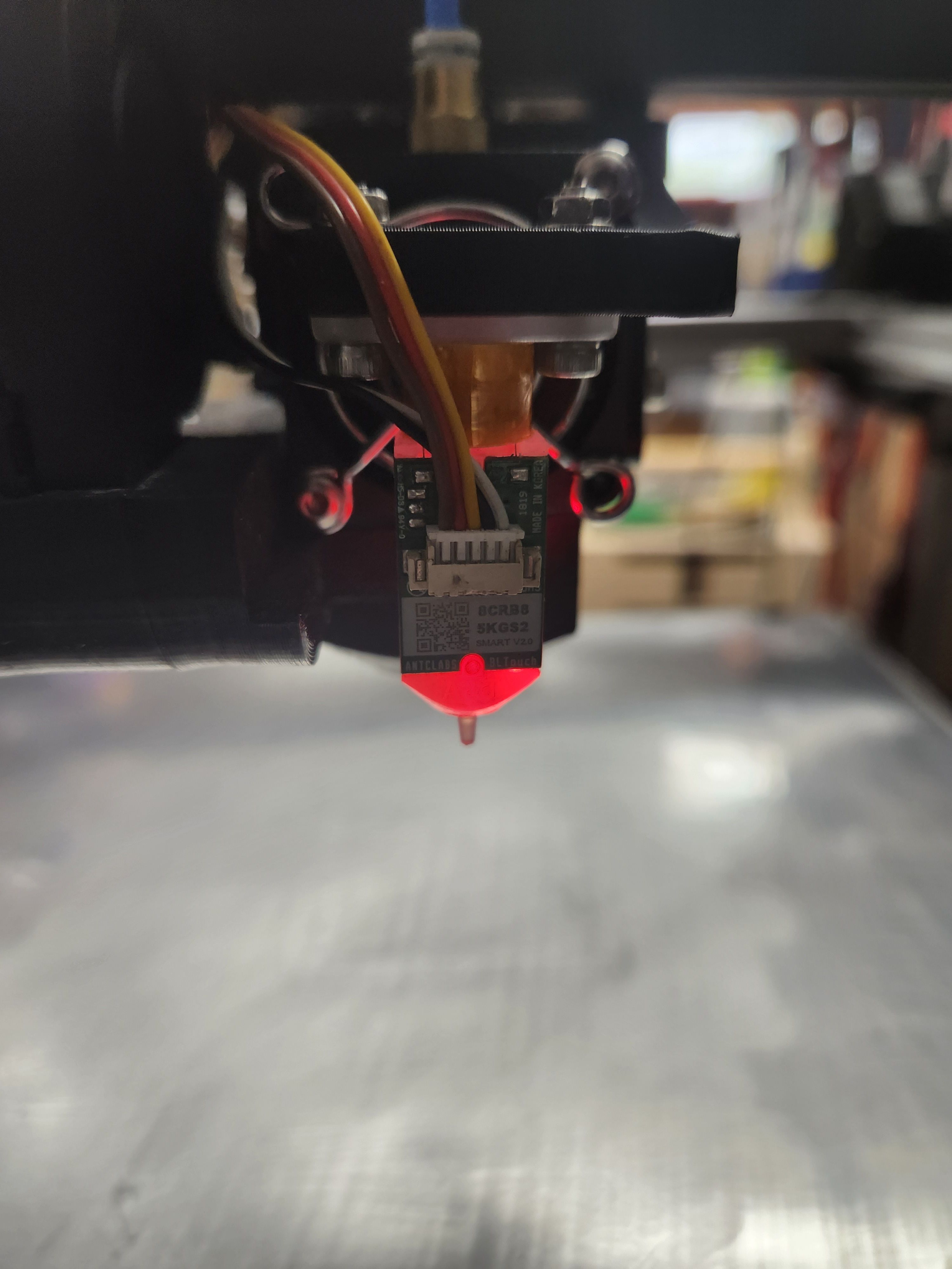

          GENUINE BL TOUCH SMART VER.2.0

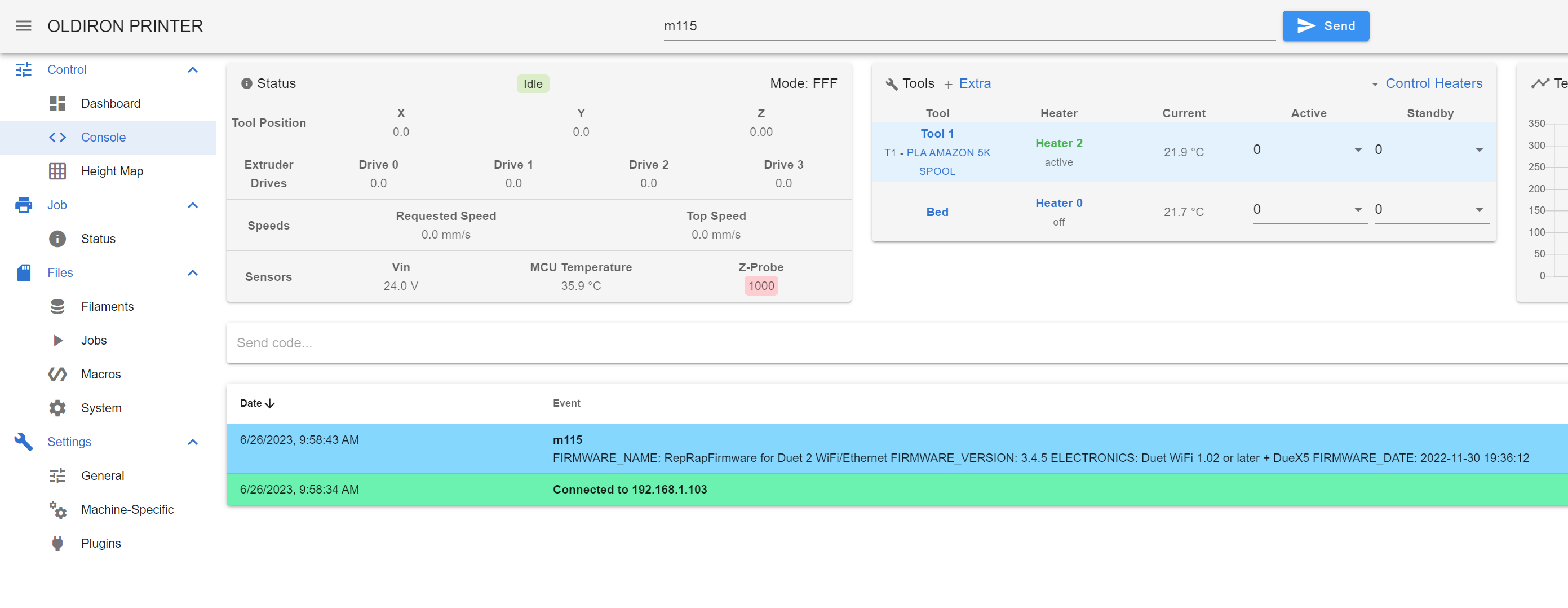

          FIRMWARE VERSION

            droftarts administrators @oldironjunkie
            @oldironjunkie You can copy the text of your config.g (or any other file) and paste it into your reply here. Extra points if you put it between code tabs. Posting a picture of your config.g makes it much harder to quote parts that need to change.
                @oldironjunkie You have connected the BLTouch to the Z endstop, not the Z-probe header. See https://docs.duet3d.com/Duet3D_hardware/Duet_2_family/Duet_2_WiFi_Ethernet_Hardware_Overview#wiring-diagram
                      @oldironjunkie See where the white and black wires go here?
                      oldironjunkieundefined 2 Replies Last reply Reply Quote 0
                      • oldironjunkieundefined
                        oldironjunkie @droftarts
                        @droftarts I have accomplished all the items. Rehooked up the power and ground to the Z-probe header. Rechecked all the wiring. Self test still peforms flawlessly. The static tect to check the probe failed. The probe will not deploy with either the M401 or the M280 P0 S10 commands. I rechecked the voltages all ok. Question I have is this. Do I need to do anything with the Z stop header. I currently have a z stop intsalled and hooked up (needed to print something asap).
                                  @oldironjunkie Can you post pictures of how it is wired now?
                                  Can you send M98 P"config.g" and post the response from the console?
                                  Edit: check the continuity of each of the wires, to make sure all of them are making a connection.
                                  oldironjunkieundefined 1 Reply Last reply Reply Quote 0
                                  • A Former User?
                                    A Former User
                                    This post is deleted!
                                      oldironjunkie
                                      @droftarts Thanks for the response. I id find a bad connection in the tiny 5 pin factory connection on the BL touch. I fixed it by replacing the harnes with a known good one. Rechecked all and it is ok. The probe now expends and retracts with the M401 and M402 commands as it should. I did the calibration set up and I can home all axis. @ questions.How do I get to home the X and Y at the endstops in th upper right corner (where it is now) but I cannot get the z to home to the pin unless I run a G30 from the console. Also at the same time I would like to probe the z in the center of the bed (A150 and Y150) as this is where most of my prints start. Below are my homeall.g file and homez.g files. I only added the commands I need. Not sure what I need to add or comment out. Also once I get it al working correctly where do I enter the offset from the Bl touch to the nozzle. It is a consistent .59. Sorry about the questions but I am completely at a loss at this time.
