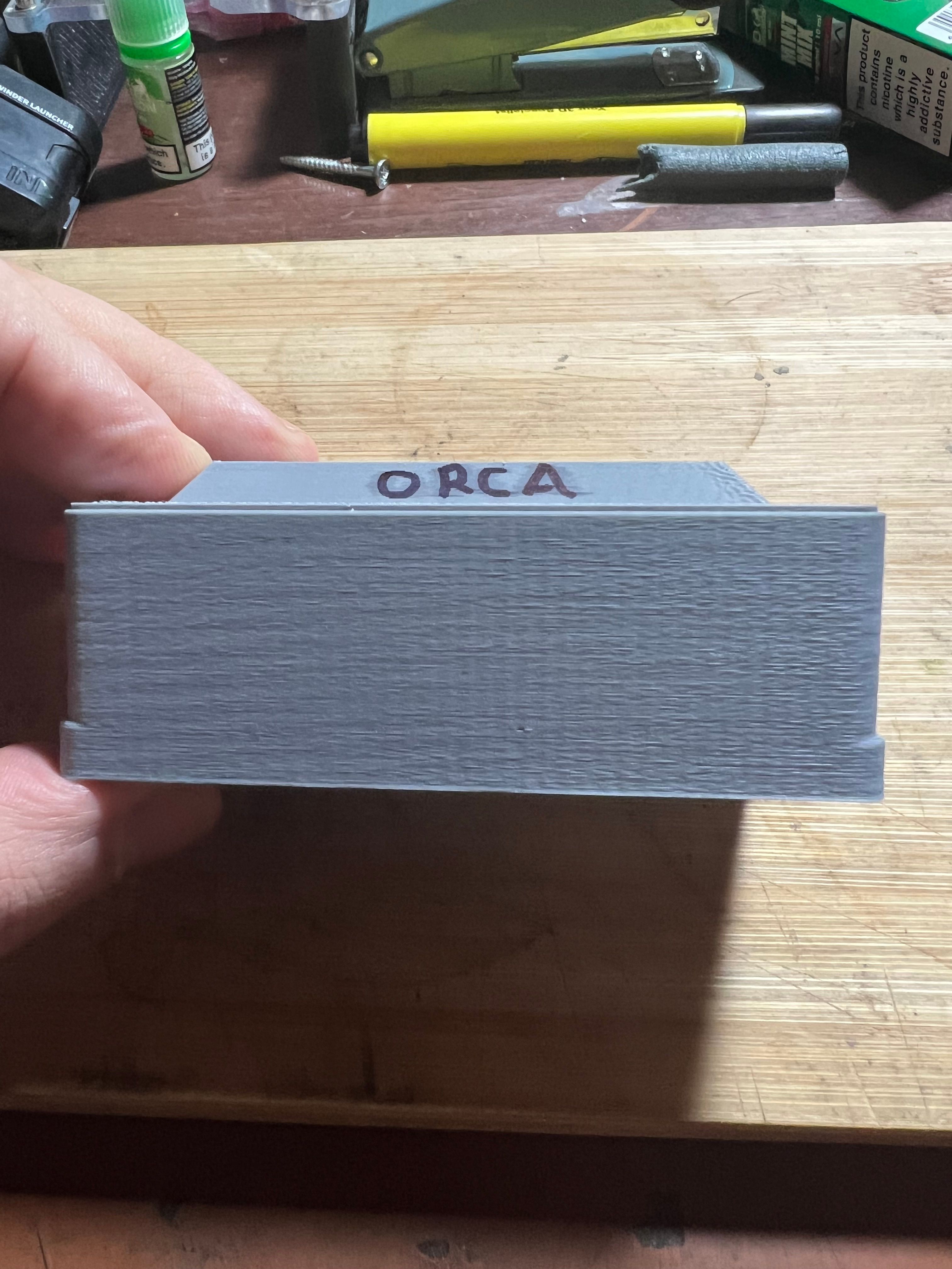

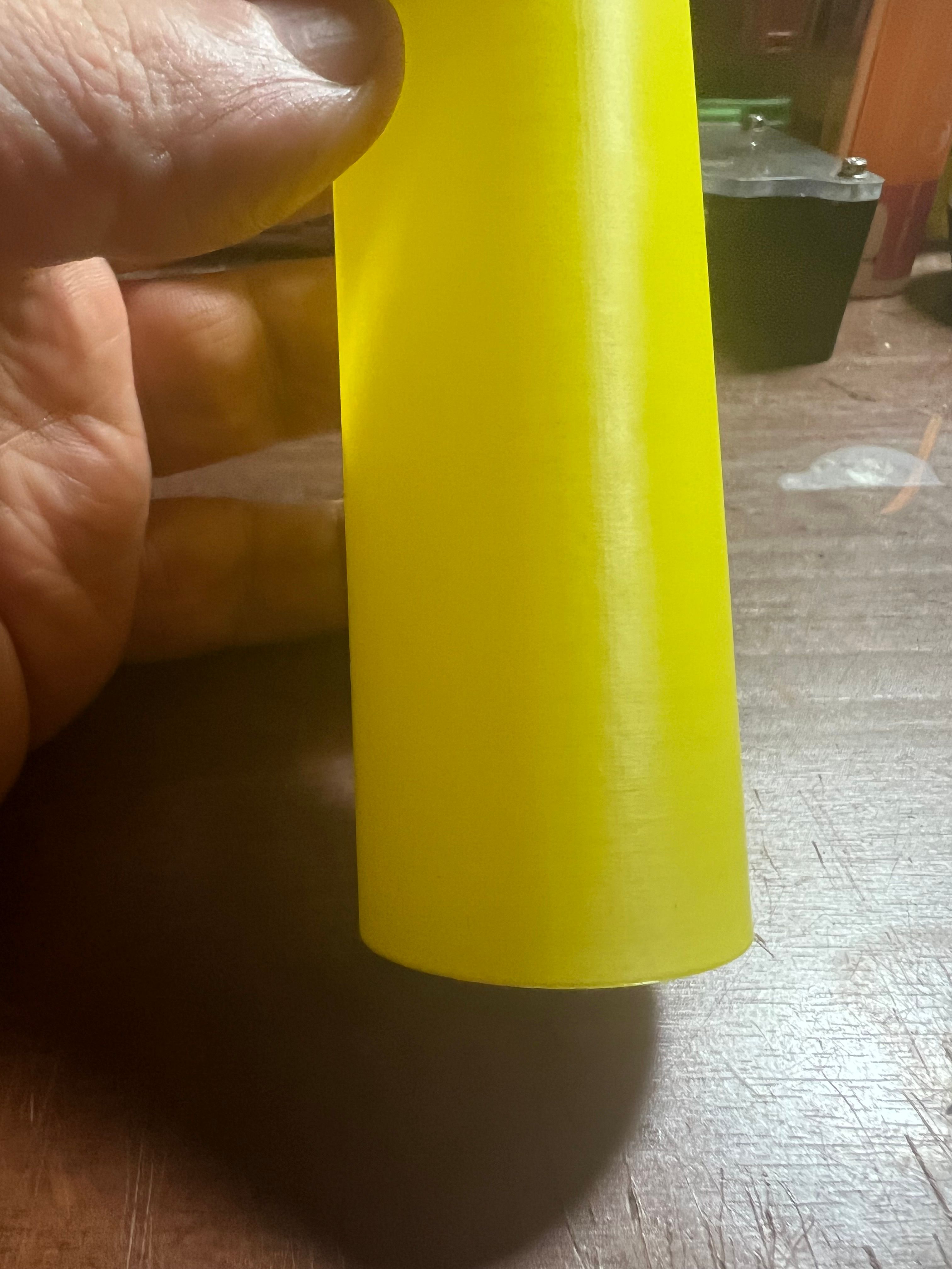

Then I run some tests to see If the banding had finally gone, unfortunately not so I decided to run some other tests to see if I could isolate the problem or ever just work out what effects the banding pattern.
This is the first test print after changing the heater and SSR as well as retuning the extruder PID. banding is the same as before.
The next test I turned off the bed heater after the first couple of layers. To see if the banding was being affected by the bang-bang theory being caused by the bed heater but the banding was still the same. This left me wondering if it was a back to a mechanical issue the good old Z wobble as nothing electrical or extruder seemed to be affecting the outcome.
The last test I did after reimaging the pi (hey try anything at this point ) This time I resized the test model from a 40mm cube the a 80mm square by 25mm high same slicing profile as before but this time the banding was a lot closer together than before, To me me this eliminates a mechanical problem as the pattern frequence is so far away from the ball screw pitch.
As mentioned earlier in this thread I have also tried a diffent slicer, so it’s also not that
I’m running out of things to try so any further suggestions from anyonre would be greatly appreciated

@Ce72 Just to eliminate it as a possibility can you turn of Pressure Advance to see if there is any effect.
@tas Hi, Here's the result of of No PA
I'm inclined to think it's a mechanical issue either in the extruder or Z axis.
Here's a wild theory - there's some interaction between the bed heater and the extruder heater, such that when the bed heater turns on, the power to the extruder heater is reduced slightly, leading to small variations in the flow of plastic. If the duty cycle on the bed heater is regular, it could lead to a regular pattern in the output.
It seems unlikely because the relay you pictured shows your bed is heated by AC. But maybe something on the control side is sinking too much current.
You could test by monitoring the voltage and duty cycle to the extruder heater.
@mikeabuilder Hi, Thank you for your thoughts, but after going down the rabbit hole replacing the SSR and bed heater, I tried running a test print with the bed heater turned off to try and eliminate the bed heater and I still had the same results. but I'm not that clued up on electrics to know if that would negate any effects.
@Ce72 Hi, thank you for your input and any suggested test are much appreciated. I have tried changing the extruder gears and that unfortunatly had no effect, as for z wobble I would have thought the pattern would be the same on all faces, but what I have noticed is that the pattern changes direction and not on opposite face so it just adds to my confusion
