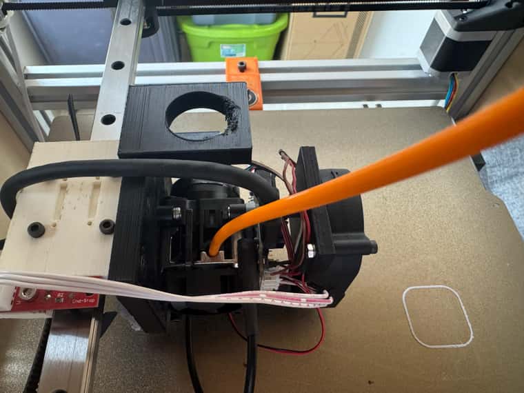

      I'm currently using the E3D roto extruder coupled with an Duet Roto Toolboard and Duet 3 6HC. I haven't been able to print ABS in my closed chamber custom printer, after 15-20 minutes the extruder stepper motor just stops working, I have verified the extruder fan is working properly, the current for the motor is correctly set as well.
      I have been using the E3D Roto for a while without issues in the same setup but recently got the Duet Roto toolboard installed. I noticed the toolboard is rated for 70C MAX but I have also seen the issue at 60C. If I let the printer cool down, I can restart the test again and again pointing to a temperature issue. Is there anything I can do?
      Attached my config.g

          dc42 administrators @arturolaz
          @arturolaz when it stops working, use M122 B121 to check whether the driver is reporting over-temperature, or the CPU temperature s reporting very hot. Note, the CPU temperature may need to be calibrated.

            @jay_s_uk said in E3D Roto + Duet Roto Toolboard - Stepper motor stalling:
            @arturolaz there is this as well about the Roto itself
            @jay_s_uk Yeah 😕 I know I am overstressing it, I just can't get around the fact that I have used it before in the same conditions and had no issues until I included the Duet Roto toolboard
            @dc42 said in E3D Roto + Duet Roto Toolboard - Stepper motor stalling:
            @dc42 Here is the console output for M122 B121 while the extruder stepper is failing. How can the CPU temperature can be calibrated?
              @arturolaz those temperatures look OK. I'm wondering whether the grounding between the tool board and the extruder motor body may be missing. If you have a multimeter, try disconnecting the tool board connector and measuring the resistance between the VIN ground pin on the tool board and the stepper motor body. It should be 50kohms if both mounting screws are connecting.

                arturolaz @dc42
                @dc42 My bad, there is no connection between them as the way I created the fan shroud requires the mounting screw not touching the toolboard but instead coming from the shroud. I have now read the wiring notes from the docs and will be trying it.
                How can this cascade to a motor stall?
                  @arturolaz extruding filament builds up static charge. If it is allowed to build up on the extruder motor body, it may flash over to the stepper motor wires. From there it flows into the stepper motor driver and may trigger the short circuit detection in the driver.
                  See also this thread https://forum.duet3d.com/topic/37882/extruder-stopping-mid-print-fixed-after-reboot.

                    arturolaz @dc42
                    @dc42 Understood. I did the test grounding the metal body of the Roto through a wire soldered to the V- terminal of the power connector in the toolboard with a 100k serial resistor but it didn't work, it failed just like before even without reaching 70C
                          @arturolaz I doubt that CoolStep is the solution because I am not convinced that the driver is overheating. How quickly after the driver stopped extruding did you take the M121? If the driver really is shutting down because of overheating then it will cool down fairly quickly.
                          BTW your M121 report says that the driver on the tool board is stalled:
                          Driver 0: pos 0, 2682.0 steps/mm, stalled, SG min 0, temp 69.9C, read errors 0, write errors 0, ifcnt 52, reads 40354, writes 0, timeouts 0, DMA errors 0, steps req 0 done 251658
                          If you haven't set the stall detection threshold using M915 then that doesn't necessarily mean that it has stopped moving, but it does suggest that it was under high load when last commanded to move.

                            arturolaz @dc42
                            @dc42 I sent the command as soon as I realized it was failing, 2minutes difference top, at that point I hadn't enabled anything related to stall detection.
                            Quick update of my tests:
                            • Disconnected the Roto motor from the Roto toolboard and rewired it to use a Duet3 stepper driver - Still failing
                            • Printed the exact same test print but now with PLA hoping that the ABS ambient temperature was the trigger of the motor failure but it also failed
                            • Inspected the whole motor assembly but found no issues apart from maybe insufficient grease on the gears (waiting for the grease to test)
                            At this point I'm almost sure the motor or some configuration is the problem but I can't find the root cause of it

                                        That's a PLA limit, to avoid jams in the hotend.
                                        Notepadundefined arturolazundefined 2 Replies Last reply Reply Quote 0
                                        • Notepadundefined
                                          Notepad @elmoret
                                          @elmoret Can confirm, E3D testing is always a "worst case" recommendation. The max motor amperage is only if they are pushing ultra high flow high pressure, in a 50+C heated chamber, for extreme lengths of time.
                                          You may want to raise your amperage as that would give you more force available.
                                          The real bamboo printer manufacturer
                                          • arturolazundefined
                                            arturolaz @elmoret
                                            @elmoret This problem started while printing ABS but I have since reverted to testing with PLA with the same results, the motor keeps stalling after 15-20 minutes of printing when coming from a cold start and sooner on later prints.
                                            @Notepad I have also tested with the absolute max current E3D recomends, 0.6A peak with the same result, I think anything beyond that might risk damaging the coils.
                                            I will open a case with E3D to be sure the motor is not damaged at this point.
                                            infiniteloopundefined 1 Reply Last reply Reply Quote 0
