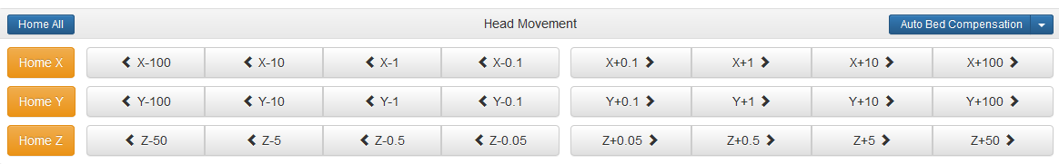

                            But I wonder if there is a scale issue, because on DWC I have that for machine control:
                            It is normal X and Y lines have different values from Z line.
                            And when I click, for example, on Z+5, nozzle moves five times more longer away than on X+10.
                            So, is there a scale issue?
                            UPDATE: I edited my config.g file and changed Z steps per mm which was totally wrong (I set a M5 lead screw system instead of a M8, but value was still incorrect, changing from 4000 to 2560, I finally changed it to 400 which seems to be right or close of the rightful value). Z line on DWC did not change but movement matches more with the first both lines, X and Y.
