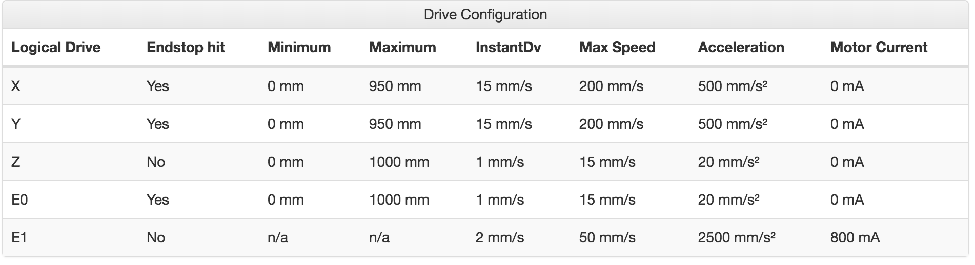

                                            It works!
                                            Disclaimer: I haven't printed with this yet. Still waiting on my bed.
                                            Took some tweaking though.
                                            I may or may not have had to make some of the changes I made. Someone else can confirm.
                                            Added the following to config.g:
                                            ;DUAL Z
                                            M584 X0 Y1 Z2:3 U3 E4
                                            Wherever something for Z was defined, I added the same for U. (I'm unsure if this was necessary, as I did this during troubleshooting.)
                                            Example:
                                            This: M350 X128 Y128 Z128 E16 I1 ; Configure microstepping with interpolation
                                            Became: M350 X128 Y128 Z128 U128 E16 I1 ; Configure microstepping with interpolation
                                            Added, as it was missing:
                                            M569 P4 S1 ; Drive 4 goes forwards
                                            Commented out the entirety of homez.g and added:
                                            M584 Z2
                                            G1 S1 Zxxx Uxxx
                                            G92 Zxxx
                                            M584 Z2:3
                                            Pretty sure that was everything!
