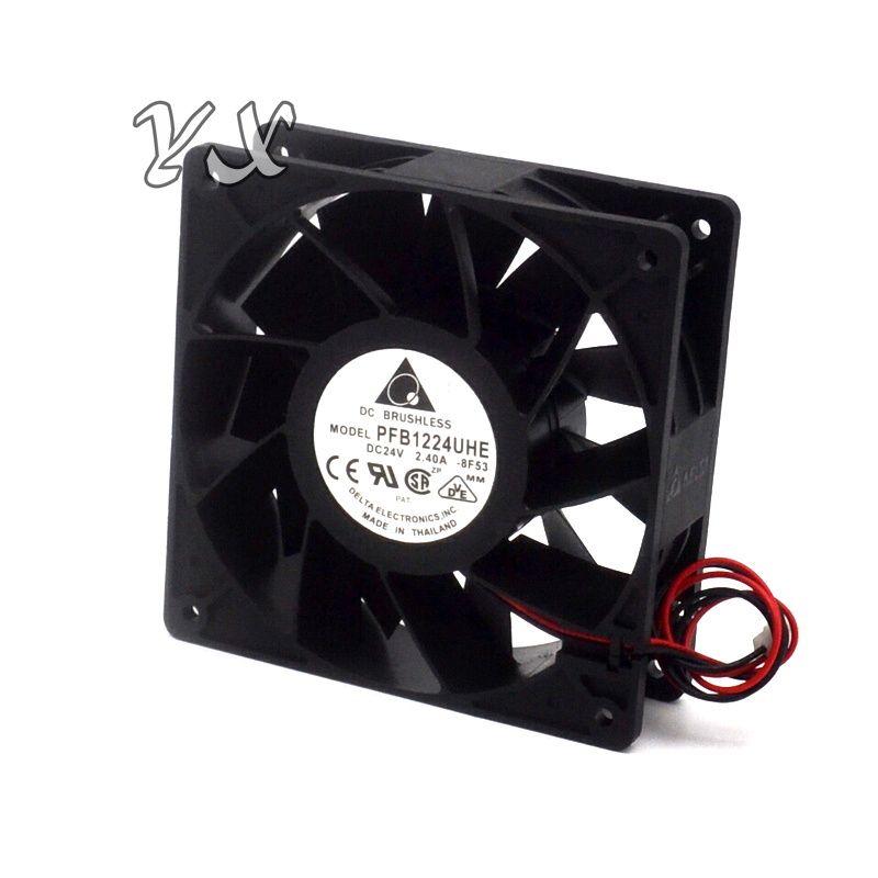

    • RE: High power fan with Duet 2 Wifi.
      @Phaedrux Thanks a lot. After reading a bit and looking at the board, it seem to be 32V DC mini blade fuse like these right?
      Now I can get spare fuses. Interestingly, a small 1A fuse is not available to buy on Digikey. Could get from somewhere else anyway 🤗 🤗
      posted in Duet Hardware and wiring
      @Phaedrux It's a bed cooling fan.
      I've read them now but still not sure because I've no background in engineering.
      Also, after hours of research. I've found another high efficient alternative which is rated 1.49A. It's NMB 12038VA-24R-GA-00
      So, I think 2A fuse is acceptable because other fans are smaller .. but a lot cheaper anyway. Anyway, this fuse size is the Ampere of all running fans in the system and which I could buy typical car fuse and replace it right?
      Thinking about another simple solution within 1A limit, the fan pressure become half of that high power one. The current for this fan is 1A with maximum 1.5A
      This fan will run about 5-10 minutes at a time. Will it be too stretch for 1A fuse?
      https://www.delta-fan.com/Download/Spec/FFB1224EHE.pdf

    • High power fan with Duet 2 Wifi.
      I'm getting a high power fan to be used with Duet 2 Wifi. The model is Delta PFB1224UHE 24V 2.4A 12cm. Is this fan supposed to work with this board? Any caution since I never installed this much power fan before.
      Also, I've read the wiki that there's brushed and brushless motor. Any idea which one is this fan?
      Here's the PDF spec of this fan on official website
      Thanks,
      Cookie
