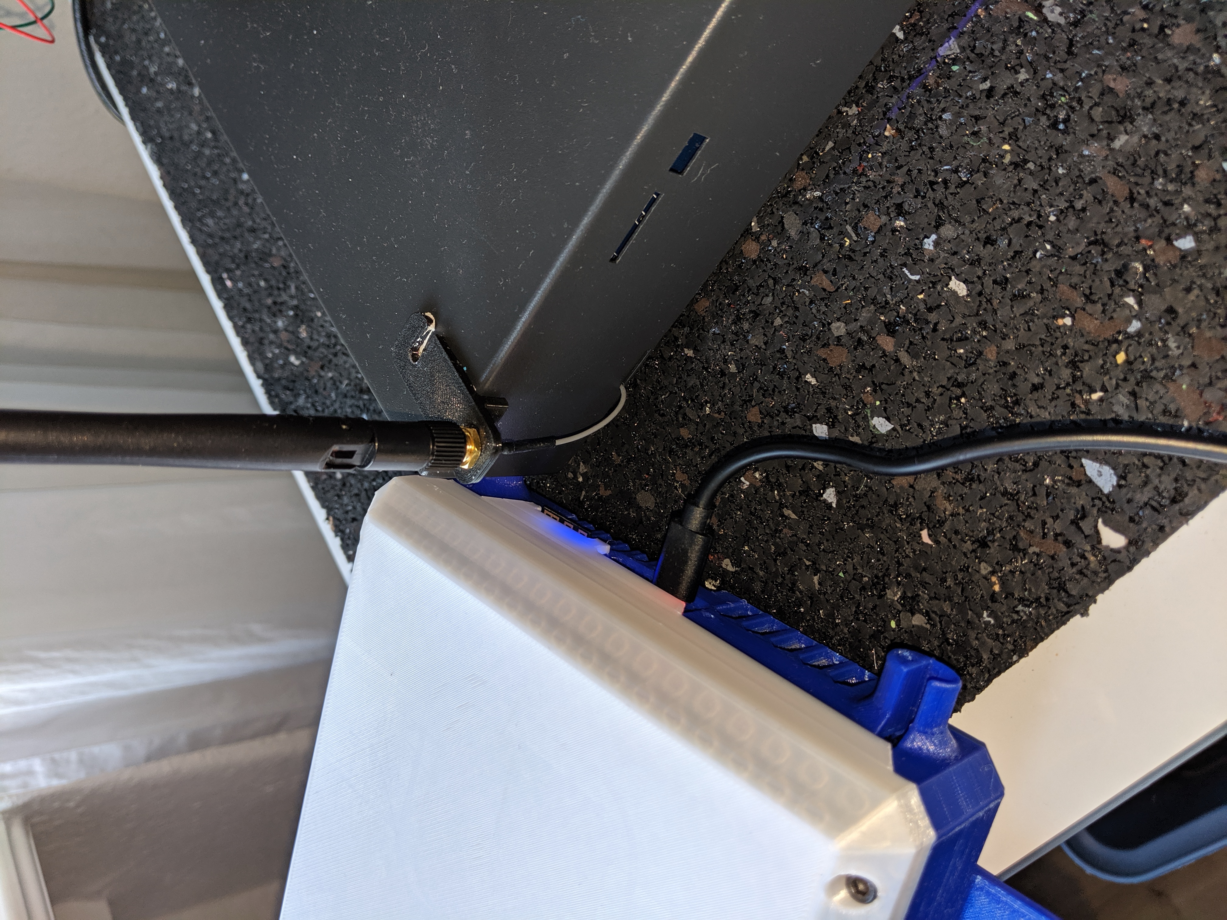

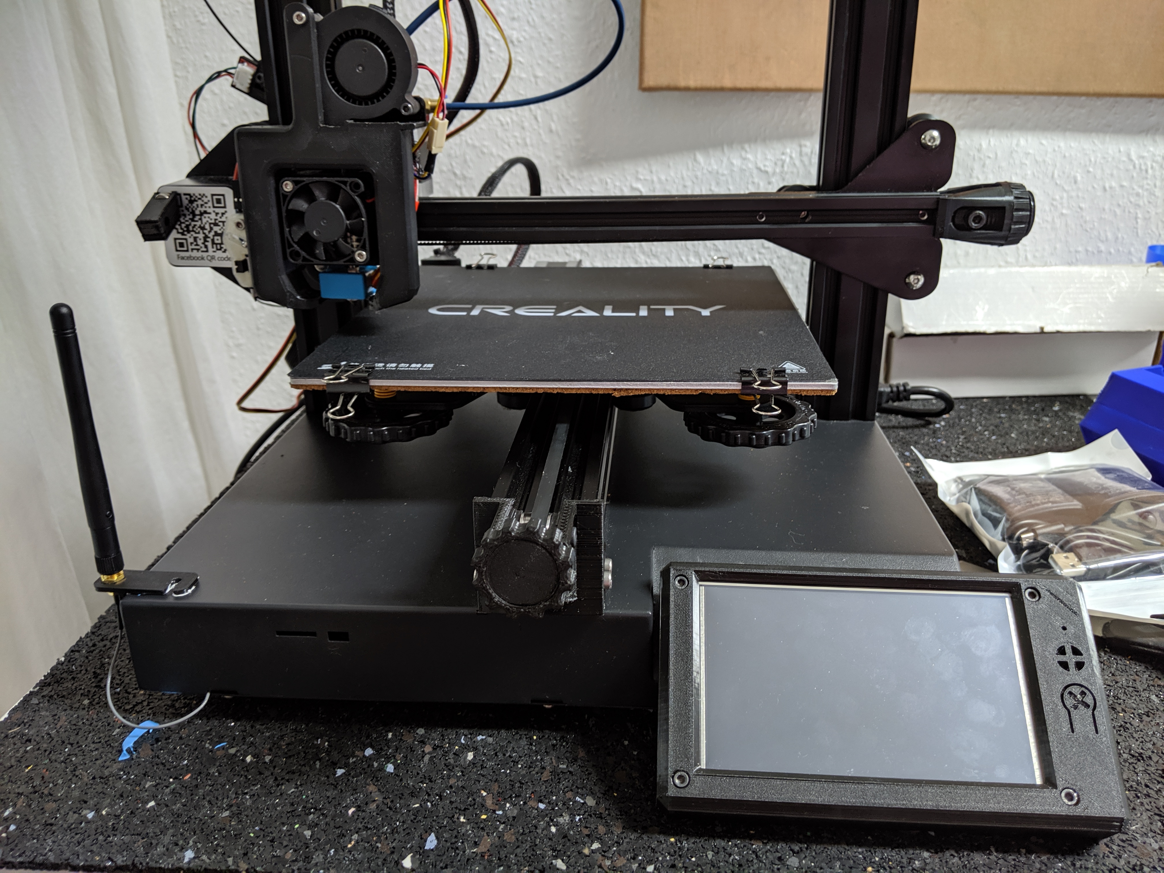

                  In my case, the signal improved from 71dB to 56dB with the external antenna ... and that's in addition to an additional wifi hotspot (the hotspot got me from 78 to 71dB, and has other uses so it's not a waste). It's pretty astounding
                  The antenna is currently in a holder taped to the enclosure of my CR-20, but all that's missing is a hole of the right size to get rid of the jury-rig.

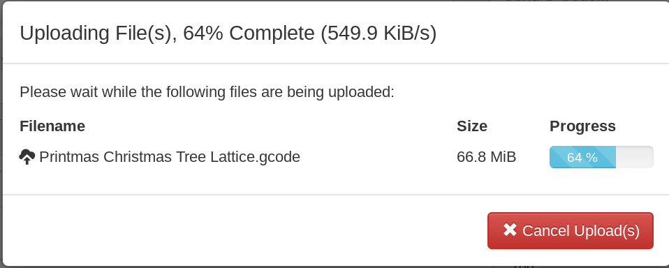

                        @zapta I just tested an upload with a large GCODE file (66Megabytes).
                        On my old setup I would achieve between 60 and 80KiB/sec, with the new setup, I got between 5 and 8 times that speed:
                        Of course, the new antenna is also in a different location, so I can't guarantee it's just the external antenna. But I am fairly sure it's a contributing factor.

                            OK, here is the surprising result with the integrated antenna located at the point where the external antenna is (which wouldn't physically be possible if I used it with the CR-20 housing and is quite different to the original location due to wire lengths .... -- the antennas are now about 6cm apart):
                            I'm not making this up (-: It just shows that with WiFi, the three most important rules are the same as with real estate: location, location, location.
