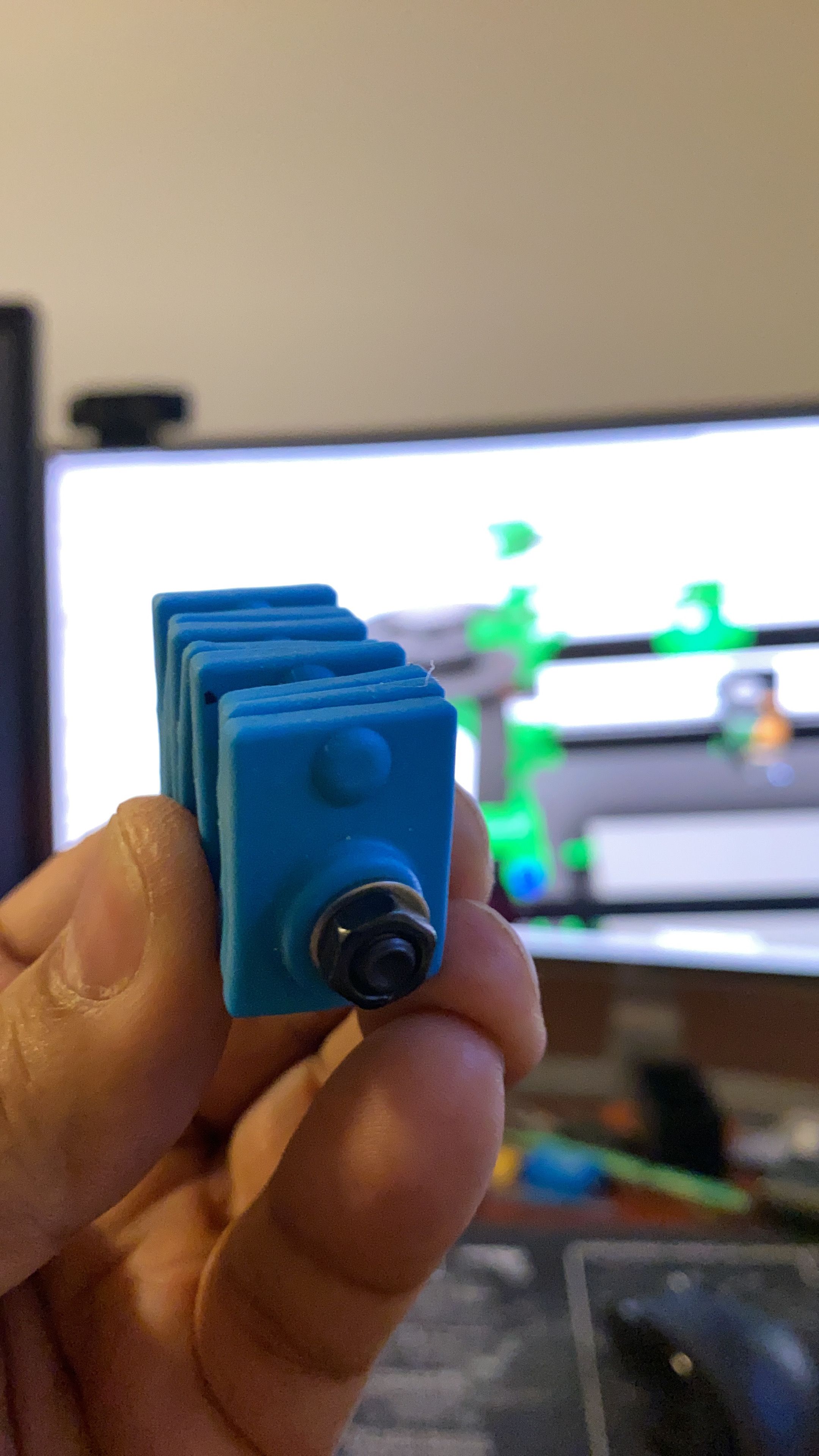

                  • Nuramoriundefined
                    Nuramori
                    One thing I did was collect all the old and torn silicone socks I had lying around and made a wipe. B97DC44A-85D2-417D-94F8-8FA5677E1E6A.jpeg
                    I just sliced off the sides and kept the face, then alternated them with washers. Used RTV on the bottom to bind them.
                    zaptaundefined 1 Reply Last reply Reply Quote 3
