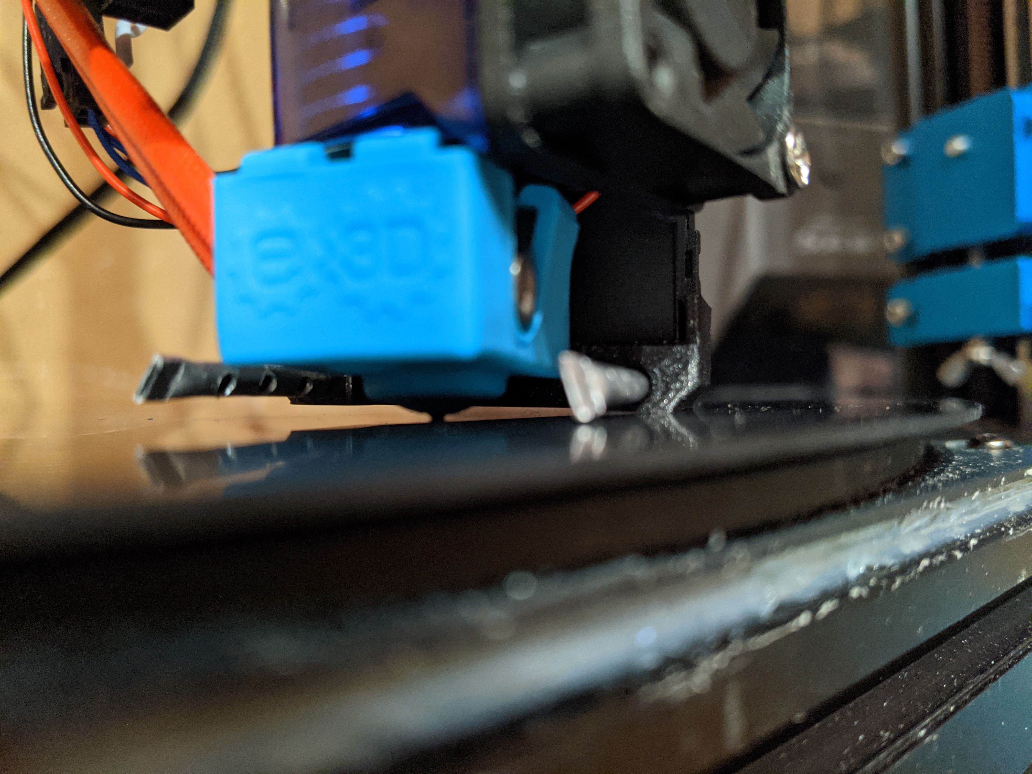

I bought a smart effector and today i assembled it to my anycubic predator. Now i noticed that the effector has a constant tilt (not parallel to heatbed). The part cooling fan is touching at one side the heatbed. But this is constant across the heatbed.
I have read the delta calibration but don't know where to look because it is a constant tilt. Also there is not given in which dimension the build has to be accurate. For example does the tower distance has to be in within +-1mm or +-0.01 or less? If i put a metal angle between a tower and the heatbed i can't see a gap (all 3 towers). So i think they are perpendicular... I installed magball arms with linear rails. With stock effector i couldn't see that tilt.Does anyone have an idea what's the problem and how i can fix this?

Looking at the pictures posted (the last one in particular), it almost appears that the hot block is mostly level with the bed, but that the fang cooling thing isn't quite straight. (That might just be an optical illusion, however.)
Are you able to take a picture of a entire printer to give us an idea of the frame construction?
@garyd9 thats it. Many many thanks for your help. Great idea to look at the heater block level. Mine is level:
So i looked to the part cooling fan and i noticed it is not really flush with the fan on this side where it touches the heatbed.
Never ever thingiverse parts.. the duct is mounted in a very bad way (only one screw at one side)
When i lift the duct by hand the gap seems to be level.
Now i will calibrate. Hope it works without problems. Thank you very much :):) -

@Bluemalu thank you for your tips but the problem is solved. The problem was the duct. It is only mounted at one side so the not mounted side sagged

Correct. if the geometry is correct, the only thing that can cause the effector to tilt is if the machine as whole is tilting. But a fan duct making contact with the bed would likely cause one of the rods to become slightly disconnected, causing a tilt.
Now i did the first print after calibrating. (I am using klipper firmware) And it worked very well. Only bad thing is the fan duct. This tusk cooler thing is sooo bad like you have no part cooling. Now i will design my own duct.
