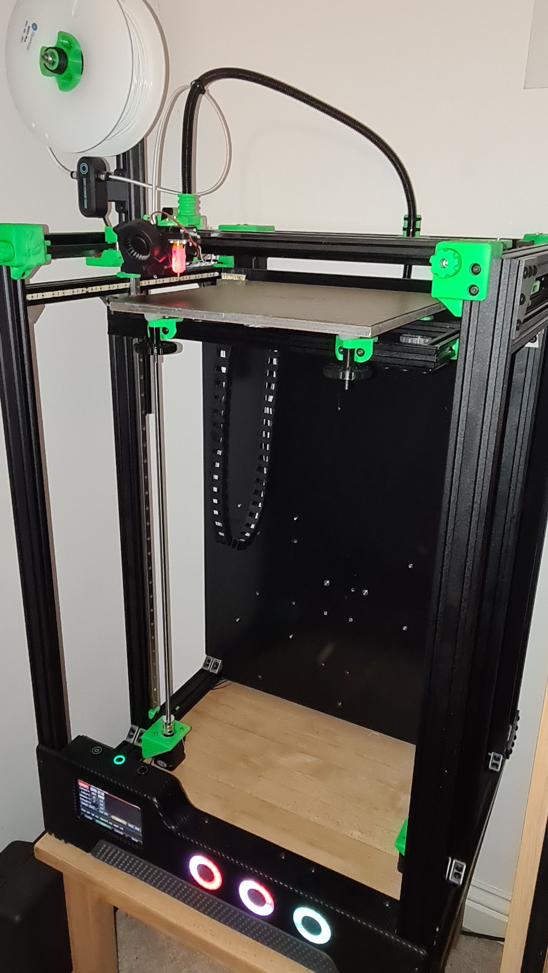

      I seem to have bad banding/z wobble (not sure what to call it) on just one axis. The front and back are ugly, but the sides are perfect.
      The printer is a core xy with MGN12 rails.
      I've PID tuned both bed and hot end a few times (numbers are always very close)
      I've stripped the rails cleaned them with IPA and reassembled - zero difference.
      Belts aren't loose.
      I cant detect any wobble in the bed.
      What could be causing this?

        @nick9one1 Very interesting problem! You have on all Axis a mgn12 rail? And you can't push or pull your print head up or down ? Can you turn this file by 45 degree and print it again? And then post it here

          @nick9one1 I don't have that kind of printer, so I can't help out a lot, but try rotating your object 45-degrees and see if you get banding on all 4 sides.

            Backlash or skipped steps on Y axis. This is corexy? Post your config.g

              @phaedrux I've rotated he box 45 degrees and the banding happens on every side - I think this means it isn't skipped steps on a single axis?
              this is the printer
              and config.g

                            @nick9one1 WOW! That's a beautiful and huge printer.
                            I'm 0% COREXY experienced, so maybe this isn't helpful at all, but of course it's the internet, so I'll share all my ideas. 🙂
                            Initially, you saw that one axis printed well and the other axis had all these wiggles. When you rotated the object 45-degrees all walls had wiggles. I think that eliminates some strange issue with the slicer or GCODE (which no one suspected in the first place) and it's still consistent with one axis working well and the other axis having problems.
                            As I understand COREXY, both "axis" stepper motor turn when you move along X or Y, they just move different directions.
                            Since you see the problem going both "West" on X and "East" on X and it doesn't seem to wiggle around as you are traveling (It looks like it's still a straight line) it seems like when the printer finishes it's last Y move, that it is not in the exact correct location in Y and that's giving you the wiggles along the X-aligned wall.
                            The wiggles look big enough that you should be able to see them with your eye.
                            I would try this experiment:
                            • Set up some kind of square block on the print bed. Could be something like a can of Spam or something.
                            • Move the print head until some part of it (doesn't have to be the nozzle) JUST touches the block. Or maybe put a sheet of paper between them and move until it just grabs the paper.
                            • Command the head to move away from the block like 50mm in Y
                            • Command the head to move 50mm in X and then 50mm back
                            • Command the head to move 50mm back towards the block in Y
                            Then see if the head is in exactly the original location. Use the paper test to see where it is.
                            I think you are going to see that the extruder is not moving to the location it needs to be.
                            If so, you can experiment with moving just in Y and back to see if that works and moving diagonal etc.
                            It really seems like something is mechanically awry in your printer and that's causing this.

                              I've done a little more reasearch and I think its also worth pointing out that on a core XY, moving just one motor moves the head at a 45 degree angle.
                              So unlike a non core XY, printing a cube square to the bed requires movement by both motors for each line printed.
                              This means that a problem like this cant be related to skipped steps, loose belts or anything to do with the motion system. If it was, the banding would show on both axes.
                              It can only really be movement or flex in the hotend assembly or bed.

                                    it was alignment of the Y rails causing the problem. Unless they are perfectly aligned they can bind.
