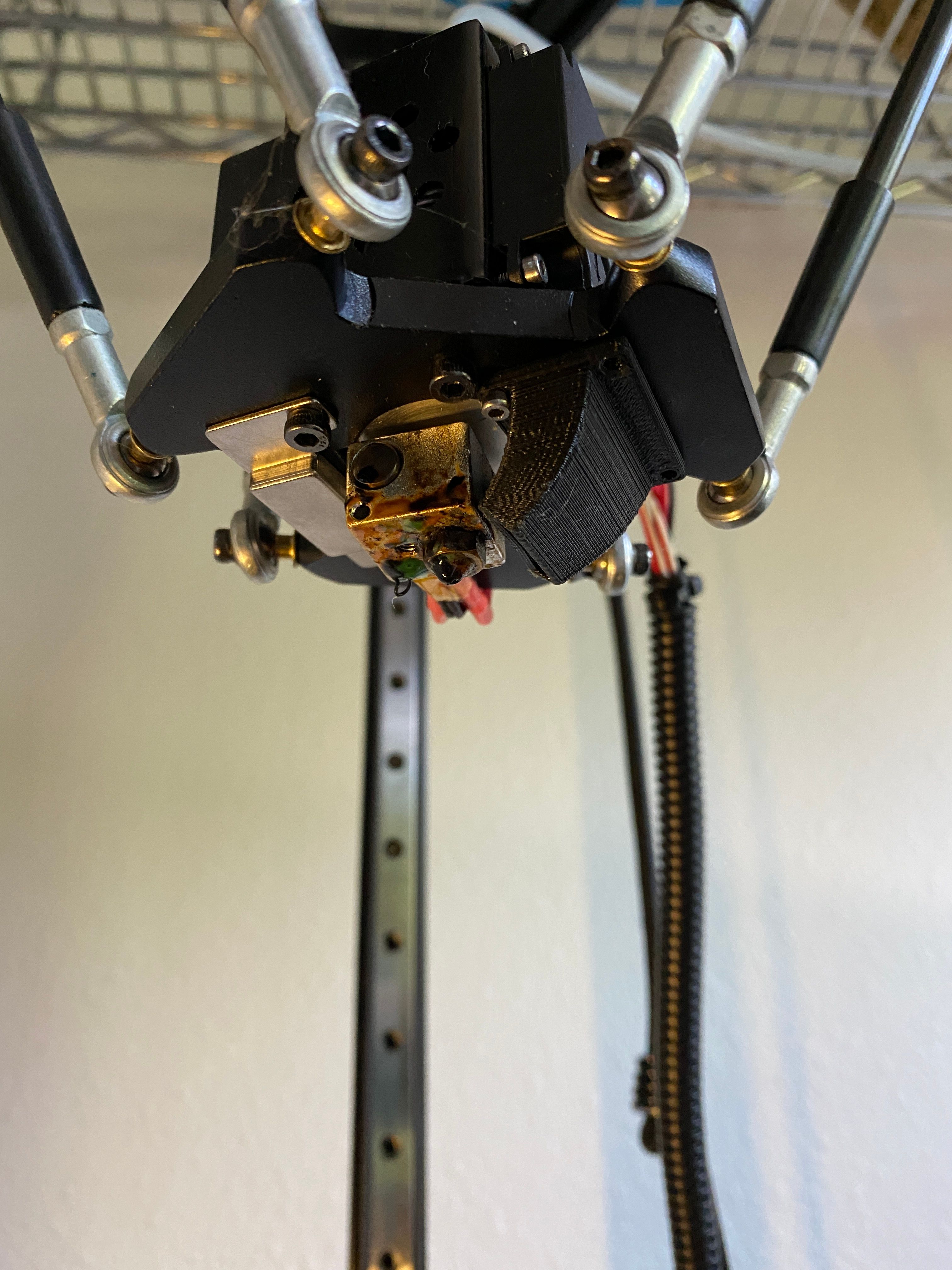

Can you give some more info about the heater setup? Maybe a photo?
What did the temp graph look like during tuning?
Firmware version? Duet mini?
Psu voltage? Heater wattage?
Is the fan blowing on the heater block? -
@phaedrux The graph was an even zigzag until the end of the 5th phase. Firmware is 3.3. Power supply is Meanwell 350 watt 12v. I think the wattage is 40w
A photo of the hotend assembly and a photo of the temp graph would help a lot in understanding why it might be giving a bad curve fit. Basically it means it's not heating or cooling at the rate the model predicts. Could be the cooling fan is blowing too much on the hot block, or the hot block is making contact with the cold end heatsink. Do you have a nozzle sock installed?

5/30/2021, 8:33:29 PM Warning: Auto tune of heater 1 failed due to bad curve fit (R=2.783, 1/C=0.0075:0.0074, D=4.9)
5/30/2021, 8:30:56 PM Auto tune starting phase 5, tuning with fan on
5/30/2021, 8:28:54 PM Auto tune starting phase 4, tuning with fan off
5/30/2021, 8:26:58 PM Auto tune starting phase 3, heating system settling
5/30/2021, 8:26:12 PM Auto tune starting phase 1, heater on
5/30/2021, 8:26:06 PM M303 T0 S205
Auto tuning heater 1 using target temperature 205.0°C and PWM 1.00 - do not leave printer unattended; Heaters

@huskypsyd Firmware 3.3RC3
@norwestie my best guess is that you don't have the print cooling fan configured correctly, so the cooling rate with fan on was measured to be slightly less than with fan on (whereas it should be higher).
If that is not correct, and the print cooling fan really doesn't have any significant effect on the hot end temperature, then I suggest you re-run heater tuning with parameter H1 instead of T0 in the M303 command. Alternatively, use these parameters:
M307 H1 R2.813 C106.4 D7.0
106.4 is the reciprocal of the value 0.0094 that was reported in the message.
@huskypsyd the reason is the same as in my previous reply, except that in this case we can see that the measured cooling rate with fan on is lower than fan off, 0.0074 instead of 0.0075.

The H1 substitution worked! Thank you. Onward to my next error ¯_(ツ)_/¯
@norwestie this issue is fixed in RRF 3.3.
