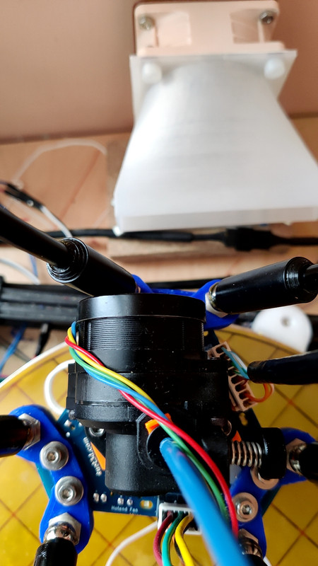

Here is what I am using with my Smart Effector.
@bberger my thought about horizontal assymetry is that it will create a turning effect for vertical motion, so it should not be much of a problem for the small incremental z movements whilst printing. I was trying to get the extruder weight as low as possible to minimise the turning moment caused by large and rapid x/y motion. The slightly wider arm spacing should also resist this turning effect better?
@amjm22 This is what mine looks like now
I have made the part cooling fan bracket vertical, and redone the duct - its much easier to get at the mounting screws and adjust the fan height. -

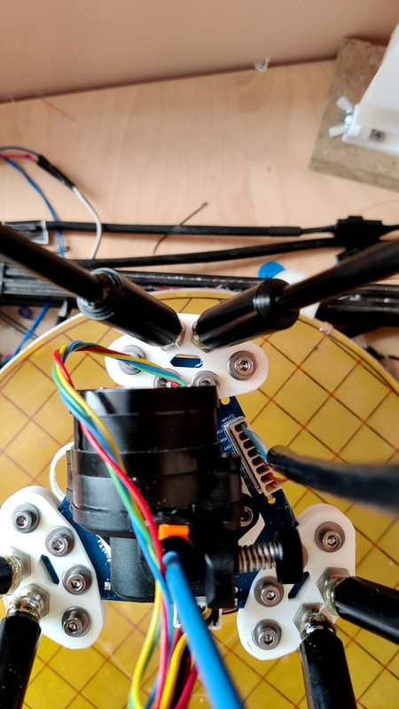

This is what I've tried so far. Just disassembled it and trying something different (all-in-1-adapter for Orbiter + SE).
Will upload pics of my current/latest attempt shortly..
I tried to keep the underside of the effector flat to the adapter so I can reuse my cooling solutions..

After ghosting got worse and worse the more I experimented with 80mm spacing I'm back to this:
https://www.thingiverse.com/thing:5162541
https://www.thingiverse.com/thing:5253693 (I remixed the excellent 2 arm rigid adapter to be a 3 arm adapter, rigidly mounting the Orbiter v2 adapter from above to the hotend adapter woth 3 screws and additionally the nut).This seems to have solved all my problems and is the clear winner.
No ringing ghosting visible without Input Shaper up to ~4k, with 42Hz MVZ the limit on my machine are the motors now (striking out at ~12k acceleration on the far edges of the bed).
I printed a 23 minute Benchy yesterday with 500mms@10k + Input Shaper (outer walls at 250mms@3k) with basically no defect.
So I'd wager to say: rigidity beats center of gravity in my case. Screwing the rigid 3 arm adapter to the tall Orbiter v2 adapter together tightly was the secret sauce. Didn't work well with just the nut on the V6 M12 heatsink.
