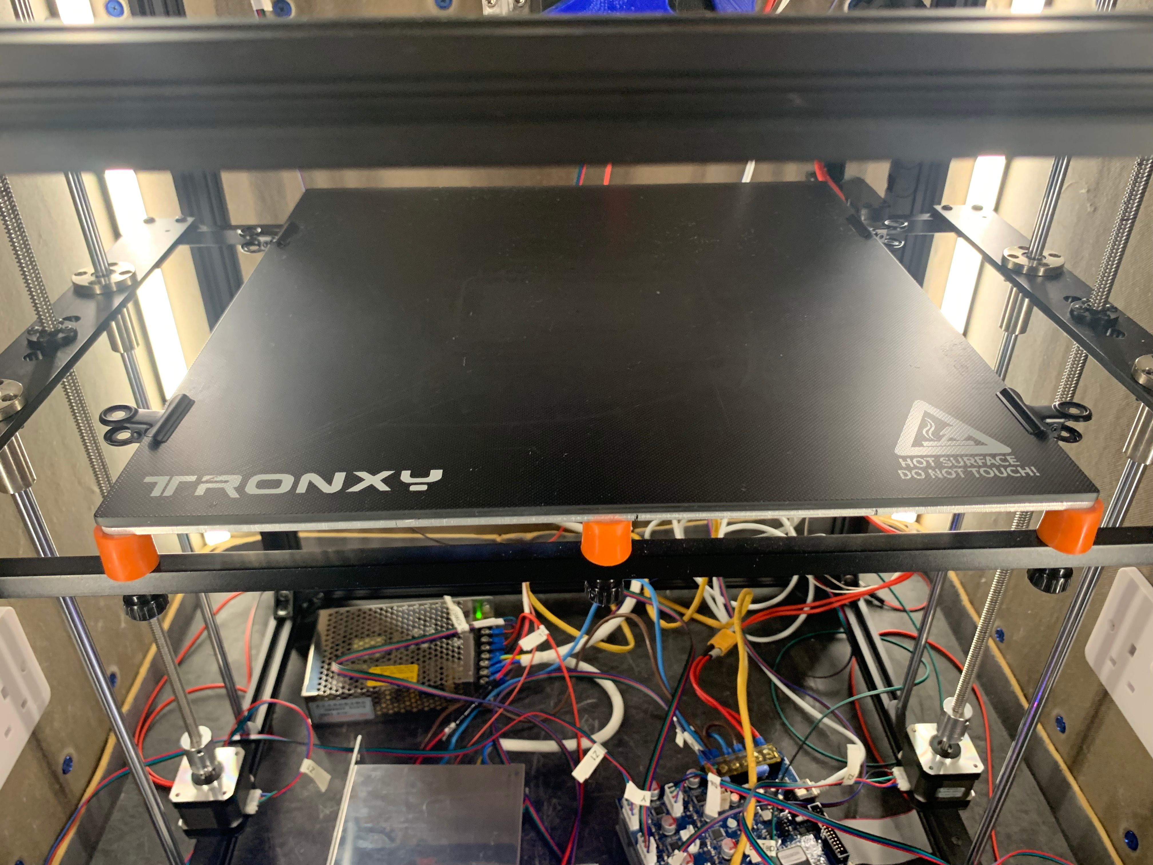

      Hi Guys,
      FIRMWARE_NAME: RepRapFirmware for Duet 3 MB6HC FIRMWARE_VERSION: 3.4.4 ELECTRONICS: Duet 3 MB6HC v1.01 FIRMWARE_DATE: 2022-10-20 16:19:01
      I'm commissioning my 6HC and I've previously been very kindly correct by @jay_s_uk regarding my incorrect use of M671.
      I'm converting my Tronxy X5sa Pro with the 6HC. It has 2 Z axis motors halfway in the Y axis and at either end of the X axis. I still have the original heatbed which is basically rolled aluminium with 6 adjusting screw. 4 on each corner and 2 halfway in the X axis front and back. For convenience, let's say I remove the 2 middle adjusters as they only warp things further, and I only have 1 adjuster in each corner.
      What I'd done previously, was I was using M671 to check the level in each corner where the 4 adjusting screws are( MBLA), and it would report how much I needed to adjust each corner from the first reference point. @jay_s_uk corrected me on this, as this should be used for where my 2 leadscrews are on my Z axis motors, which it now is.
      So although I'm still in the process of commissioning, I'm very green still and learning, doesn't this mean that i now have to manually level each corner with a piece of paper, or is there a way I could implement checking the level of the 4 corners of the bed using MBLA before I run a bed compensation.
      I've thought a little and starting looking at maybe a macro, but both the MBLA and bed levelling for independent Z axis motors both use M671, so is this even possible?
      If so, in what order should I run things, G32 - Macro (MBLA) - G29, or Macro (MBLA) - G32 - G29?
      I'm currently in the process of organising a independent triple Z axis with 8mm cast tool plate, and also looking for advice on magnets and adhesive for the magnets?
      Config.g

        Instead of leaving an adjuster in each corner, see if you can get away with leaving two corners on one side, and one in the middle on the opposite side to make a triangle for a 3 point adjustment. One of those corner points could actually be fixed, and then you only need to adjust the remaining two for tilt and roll. Of course this only makes sense of the bed itself is stiff enough to resist sagging or wild warping if left unsupported like that.
        With only 2 motors on either side the best you can do is tilt correction. I don't know what your budget is, or if the frame construction would lend itself to it, but I would either look into removing one motor entirely and use a belt linkage to turn the second side, or add a third motor for actual tilt and roll correction.
        @Dizzwold said in Twin Z axis Motors and MBLA:
        Technically you can use both. You can get the bed tilt corrected with the motors, and then you can use the method you were using to adjust the bed screws.
        Just send the M671 command to set the tilt points for the motors, probe the points and it will auto adjust the motors, and then another to set the points for the adjustment screws and probe those points and manually adjust.
        Then on top of that you could use a G29 mesh for the surface irregularities and correct for any remaining tilt/roll.
        You can do all of that within bed.g and call it with G32 if you like. Does that make sense?

          jay_s_uk @Dizzwold
          @Dizzwold for a while I had an FLSun cube, which is a pretty similar setup to what you've got.
          I would use a combination of a manual levelling macro to adjust the 4 screws and G32 to initially get it level and then after that G32 was all that was needed.
          So I would first adjust the bed so it was set square to the bed frame, i.e. adjust all 4 screws to the same length, then run G32 to get the bed frame level and then the macro for the 4 screws (and adjust until they were all the same) and just run one then the other until it was flat.
          this is pretty much my manual levelling macro https://teamgloomy.github.io/useful_macros.html#manual-bed-levelling
          The M671 locations are the locations of the 4 screws holding the bed down.
          And this is the bed.g (G32) levelling macro I use https://teamgloomy.github.io/useful_macros.html#bedg-file-for-g32

              Take a look at the printer in my signature. Rather than use 3 z motors for leveling, it uses a single z motor and 3 lead screws belted to it. The bed plate has 3 point leveling with adjustment screws. Once the screws are adjusted they don't really need a change unless there's been some percussive maintenance. So once manually leveled I run a mesh, and that's it.
              Once you have 3 motors, you have to keep them in sync, or re-sync them regularly. A single motor has no such need. Though syncing up the belted lead screws initially can be a bit tricky, since once the belt is on, they all want to move together.

                      Hm, Maybe I don't or there is something else a-miss. In the 1st image everything looks fine, but in the 2nd image everything gone pear shaped;

                        @Dizzwold can you run G32 again before you run G29?
                        that is a decent dip in the bed though.
                        If you put a straight edge on the bed along the X axis can you see anything like the 1mm dip its showing?
                        What type of probe are you using?

                              • gloomyandyundefined
                                gloomyandy @Dizzwold
                                @Dizzwold It's a bit hard to see if that step is in the X or Y axis. If it is in the Y axis so the first half of the entire probe is one level and the second half is another, then that may be due to lost steps in Z movement. If the step is in X, so that it happens as the head scans left/right then I'd be checking that nothing is "pulling on the print head" like a bowden tube or wiring and causing movement.

                                  Oh dogs balls, that could be my hotend cable chain, rather the nylon cable braid around it.
                                  The idea of the cable braiding was to stop the cable chain inverting inwards and blocking the path of the carriage.
                                  Dizzwoldundefined 1 Reply Last reply Reply Quote 0
