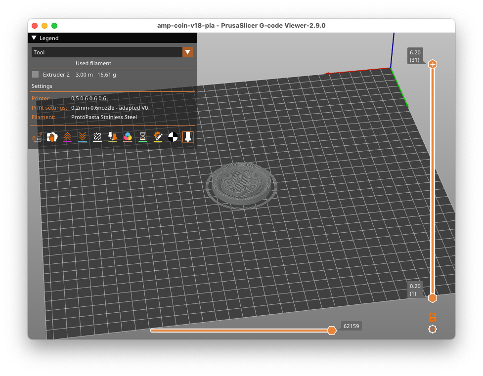

                                    • gnydickundefined
                                      gnydick @droftarts
                                      @droftarts amp coin v18 - PLA.gcode

                                        I looked at the file you sent, but it seems to only have one object?

                                          gnydick @droftarts
                                          @droftarts yes, I realized that later, let me upload it again.
