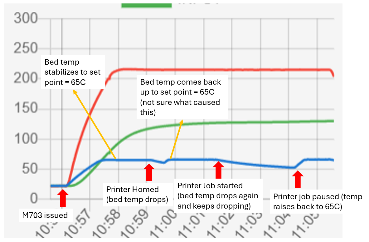

                  When I send M140 when job is running, I get
                  Bed heater 0 (slot 0) is currently at 62.4°C
                  At this point the temp has already dropped from 65C - which is the setpoint for the bed.
                  Below temperature graph shows the same - Blue line is the bed temperature
                  The pause.g is below

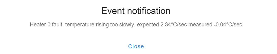

                  And eventually, after a while I get an error message

                        @dc42 I updated the heater control mode from Bang-bang to PID in the config.g file using the results from a previous auto-tuning cycle (M303 H0 S65).
                        The parameters I applied were:
                        M307 H0 R0.740 K0.402:0.000 D3.89 E1.35 S1.00 B1
                        Unfortunately, I am still observing the same issue — the bed temperature drops.
                        Interestingly, after switching the bed heater to PID control in config.g and removing the redundant bed heater settings from config-override.g, the bed maintained the setpoint temperature (65°C) correctly after running M703.
                        However, the bed temperature immediately began to drop once I homed all axes — even before starting a print job.
                        If no additional actions are taken after running M703, the bed heater maintains temperature without any issues. This behavior seems increasingly bizarre.
                        I also double-checked the first few lines of the G-code. There is nothing that would turn off or modify the bed heater during the first layer or afterward.
                        This seems to rule out issues #1 and #3 from your troubleshooting list. I will next check on #2 (the LED status on the SSR) and report back.

                            When I had initially changed to PID control, I had just changed B1 to B0 in M307 command (from auto-tune) for bed heater. I have now updated the M950 to include Q10 parameter.
                            I want to illustrate what is happening with bed heater in the graph below:
                            Very bizarre behaviour and not sure what is causing this. Going back to previous suggestions for troubleshooting,
                            To answer your previous question: "does your SSR have an LED to indicate that the control circuit is receiving power? If so, is it illuminated while the bed temperature is dropping, before the heater fault is raised?"
                            Yes, I observed the LED indicators on the SSR during operation. While the temperature is dropping, the control side LED remains ON, indicating that the control circuit is receiving power. However, the load side LED is OFF during this time.
                            After running the M703 command, both the control and load side LEDs cycle rapidly (turning ON and OFF) as expected while heating to the target temperature. Interestingly, once I home the printer or begin a print job, the LED activity slows significantly — and at times, the load side LED remains OFF altogether.
                            droftartsundefined dc42undefined 2 Replies Last reply Reply Quote 0

                                  @dc42 There is no start.g file. However, I have start and end G-codes in slicer. The start G-code in Slicer is
                                  M98 P"StartPrint.g"
                                  The contents of StartPrint.g are as follows:
                                  M106 P2 S1			; Set fan (LED)
                                  G21			; Set Units to Millimeters
                                  M290 R0 S0
                                  G28			; Home all
                                  M703			; Configure filament
                                  G0 Z10 F3600			; Move
                                  M190			; Wait for bed temperature to reach target temp
                                  M116 P0			; Wait
                                  M98 P"0:/data/initData"			; Call Macro/Subprogram
                                  M400			; Wait for current moves to finish
                                  M290 R1 S{global.dato0}			; Baby stepping
                                  G0 X1 Y0 Z0.2 F3600			; Move
                                  G1 Y40 E35 F180			; Move
                                  G92 E0			; Set Position
                                  The initData sets variable to 0

                                    @droftarts Looking at the SSR, the it doesn't seem like bed heater turns OFF when LED turns OFF. Is there a good way to test this?
