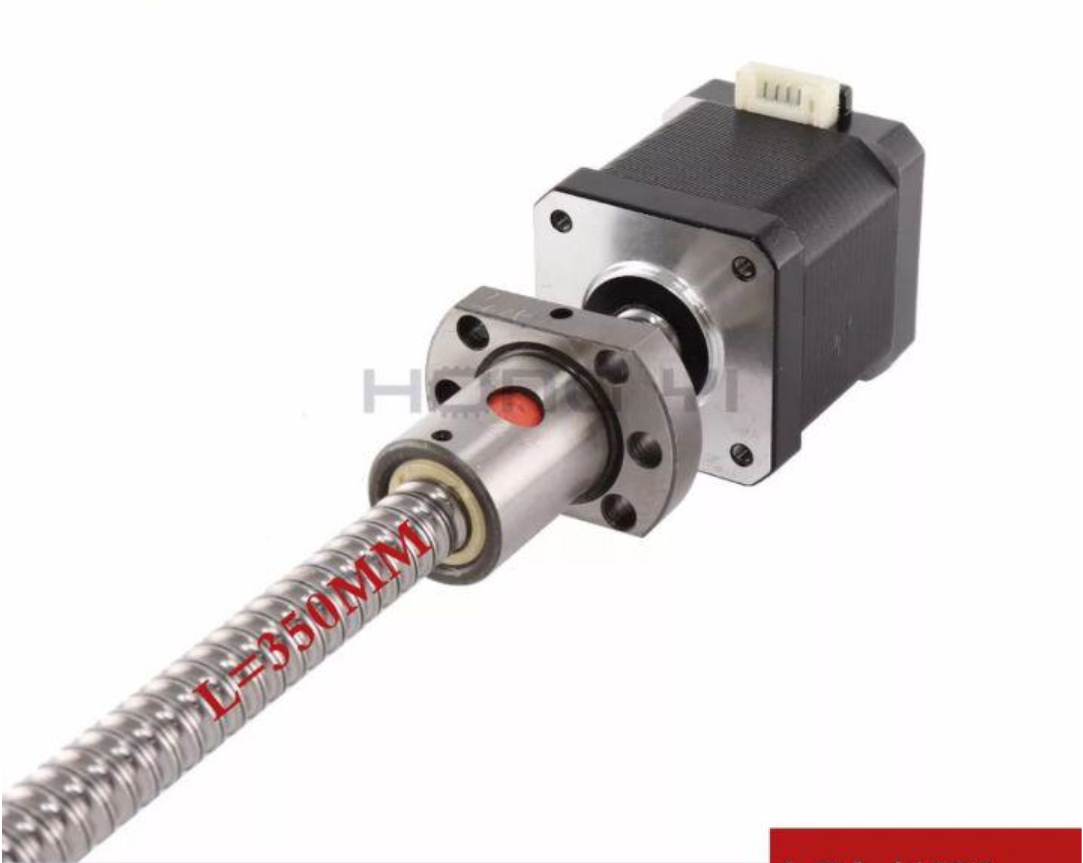

                    what about sfu1204. you would not need the coupler.

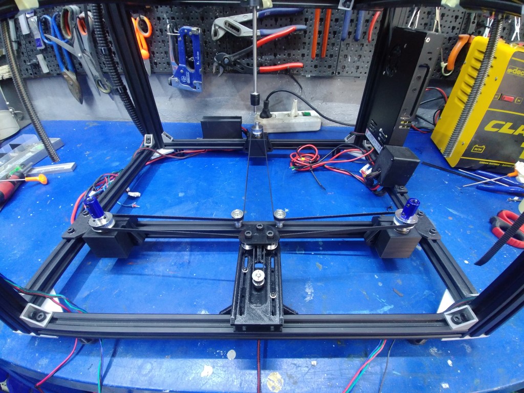

                                  • claustroundefined
                                    claustro
                                    Thank you for all your suggestions.
                                    This is what come out .
                                    I moved the thrust bearing on the top so it can discharge the weight of the bed on the plastic structure.
                                    Below I installed the ball bearing that doesn't have to manage weight.
                                    I am still waiting for the rigid coupler.
                                    what do you think
                                    2_1559396358318_20190601_151644 (Piccola).jpg 1_1559396358318_20190601_151656 (Piccola).jpg 0_1559396358317_20190601_151713 (Piccola).jpg
                                      Looks good to me.
                                      • deckingmanundefined
                                        deckingman
                                        That'll do.

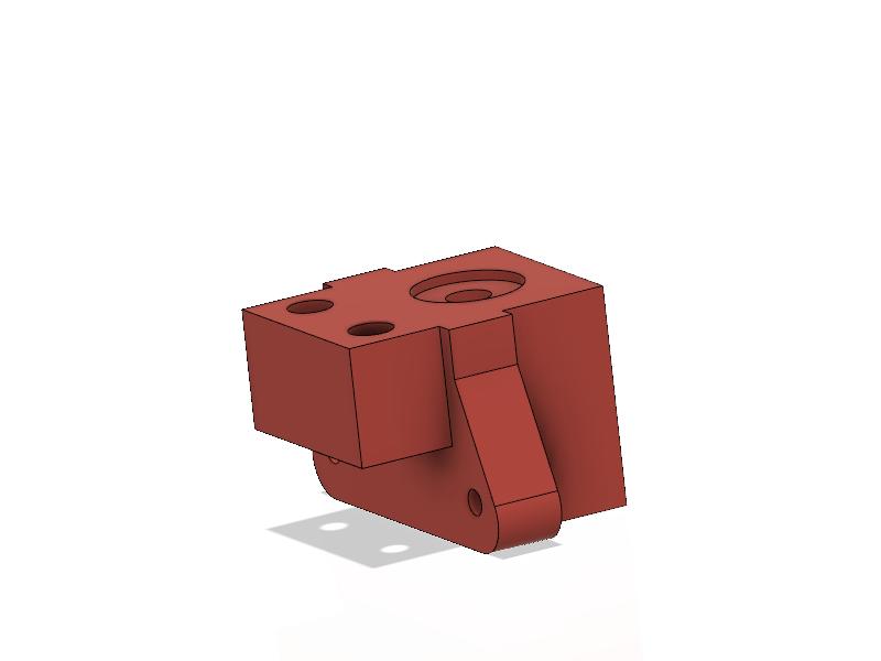

                                        • mrehorstdmdundefined
                                          mrehorstdmd
                                          With this sort of thing I tend to think about what might go wrong and what I can do to prevent it. I try to only have to do things once. Making things as close to ideal (in the relevant properties) as possible reduces the things you have to consider if something goes wrong. If I use a plastic part in an assembly I tend to make it bulky to ensure rigidity, so I wouldn't use thin plastic flanges, even with side-webbing, to support a relatively large weight or something that will be loaded by a drive belt.
                                          At the very least I would thicken the flange that bolts to the top side of the t-slot, maybe to the point of making it continuous with the body of the part. I'm not saying that your flange design won't be adequate, but if it isn't, you'll be redesigning and reprinting.
                                          In the end, you should worry less about the plastic flexing and more about the t-slot it's bolted to twisting.
                                          claustroundefined 1 Reply Last reply Reply Quote 0
                                          • claustroundefined
                                            claustro @mrehorstdmd
                                            @mrehorstdmd
                                            is something like this enough "bulky"?
