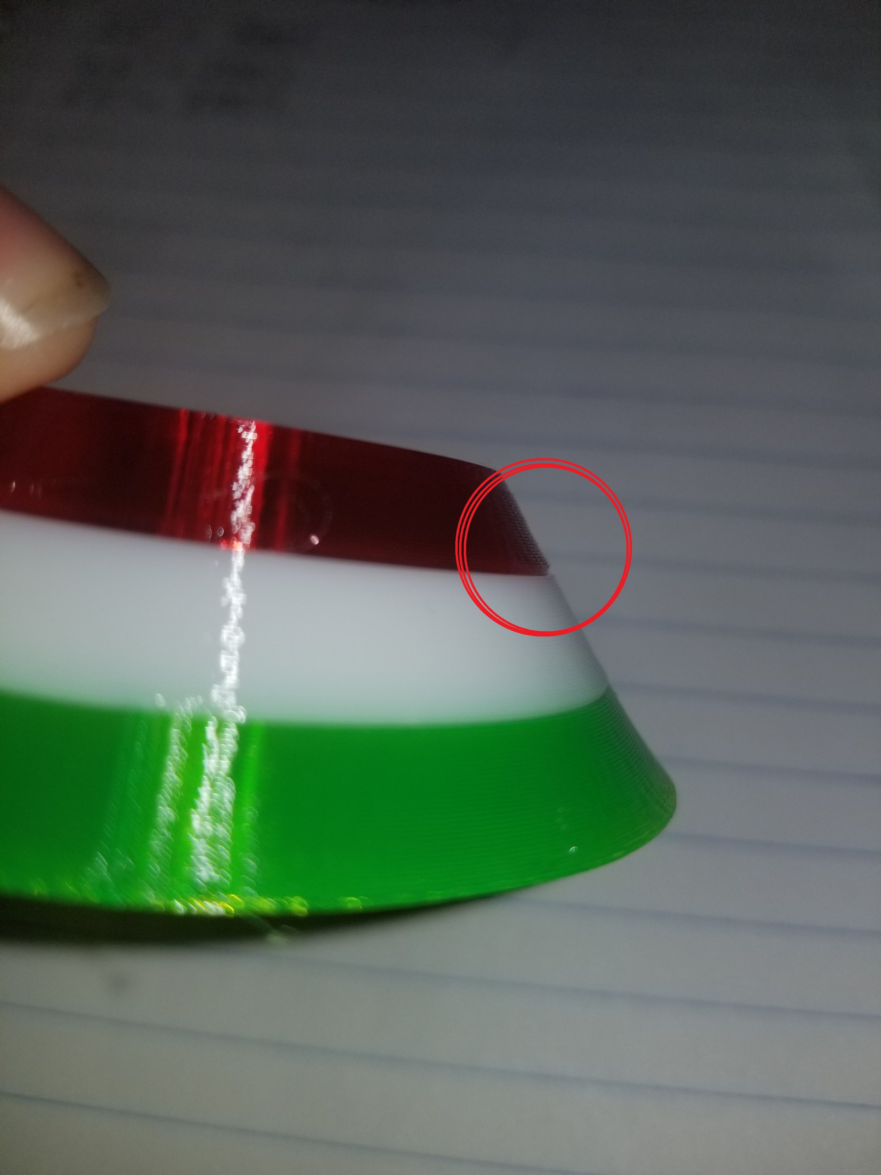

I'm getting into multi color printing. Right now I have is set up in prusaslicer so there is a M600 on my color change. The print head parks, I run an unload macro, then I swap the filament, run a load macro, then resume the print.
I'm having issues with what appears to be under extrusion after the filament change. There is an indentation on the color change layer. It is not a layer shift, and it happens for the whole layer, independent of model size.
Can you post a photo of what you mean?
@phaedrux Notice the angled transition from white to red
Same one with green to white.
It should look like this where the layer is solid and you can't really see the transition.
This happened on multiple of them. I'm thinking it might be my Z axis.
Perhaps the nozzle is not completely primed when it's going back to print. What order are your perimeters printed in? Inside out, or outside in?

@o_lampe It's a hemera. There should be plenty of print moves to "build up" chamber pressure before it moves onto the next layer. It would also show issues with retractions as well, which it does not, and it is even on all of the parts. I think it might be an issue with my Z axis not moving back into place correctly.
It does sound like a z height issue then, either mechanical or maybe thermal?
But you show that it doesn't happen every time, correct? So what is different between the times it happens and doesn't happen?
@phaedrux No idea. I think it's mechanical. I'll look into my couplers and lead screws. I have no idea what happened to the one where it worked correctly. I'll change my pause and resume g-codes so it doesn't change Z height and we'll see what happens.

@o_lampe It's a corexy. There are 4 Z motors. I need to get the spider couplers instead of the spring couplers.
Yeah, definitely my Z-axis. I ran some prints and changed my pause and resume to not lift Z and the indentation is gone. Looks like I need to get some pillow block bearings for the leadscrews and new couplers.
