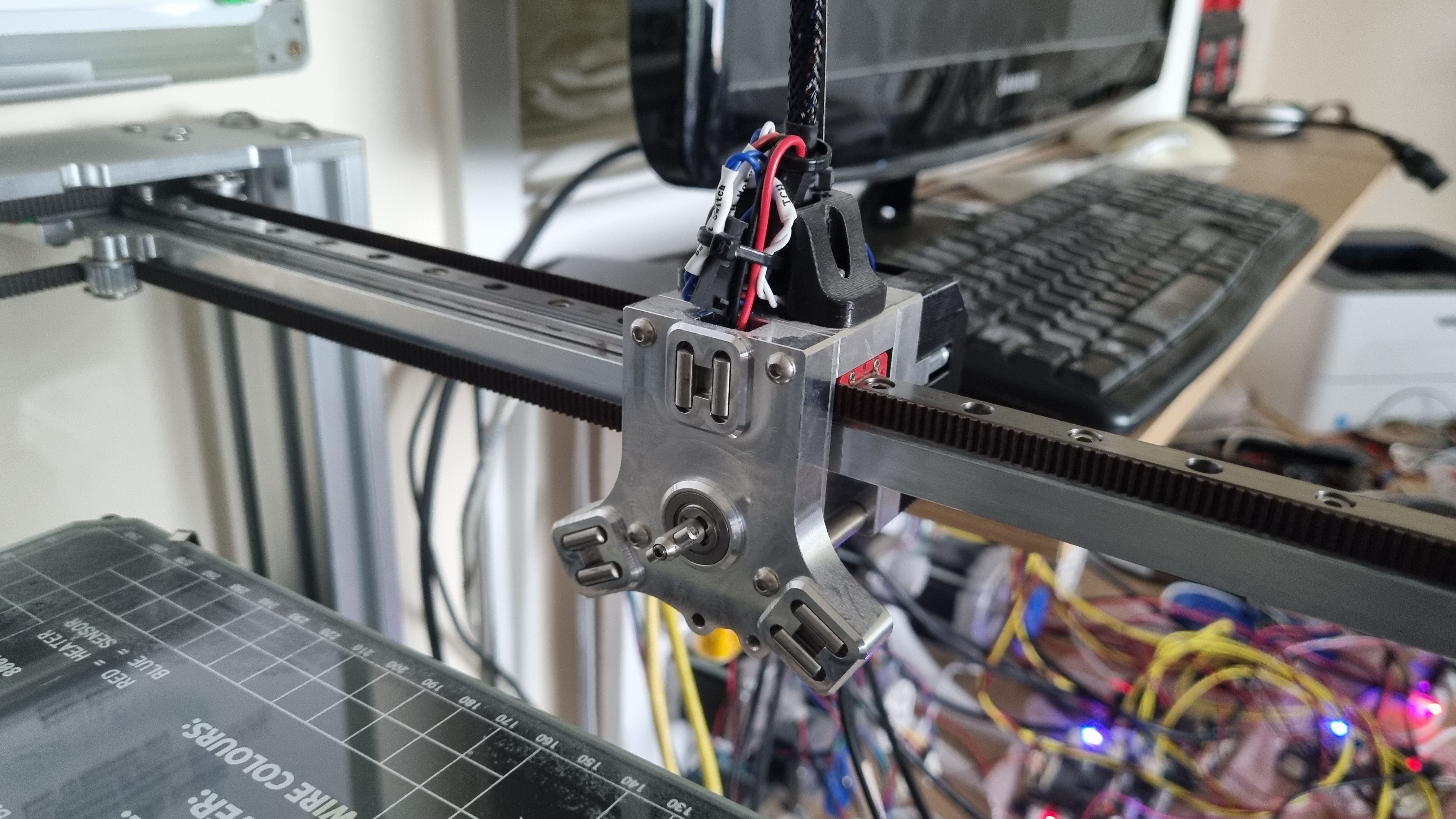

                    @eyperry Hi, thank you so much for your help with the firmware update - it is finally now updated and the Z stop is working. I have however now run into another issue - do I need to post this as a new post? My issue is that now when I home the coupler C, it does not go into a horizontal position. When I run the Coupler-Lock macro the coupler is vertical as expected, but when I run Coupler-Unlock macro it is not horizontal. Would you be able to help? Thanks again in advance. Best, Emma
                    I have attached images of the two positions below so you can see it is not horizontal.CouplerUnlock.jpg CouplerLock.jpg
                      dc42 administrators @eyperry
                      Hi Emma, nice to see we have some lady engineers here.
                      When homing the coupler on my TC, it first turns to this position and stays there for a while because the homing command drives it in a clockwise direction for a while:
                      Then it turns anticlockwise approx. 135 degrees to become horizontal.
                      Of the two photos you posted, which is the one it moves to initially when homing? Does it rotate anticlockwise in the next phase of the homing sequence? If it rotates clockwise then you need to swap one pair of the stepper motor phase wires, or reverse the direction in the M569 command for that driver.
                      eyperryundefined 1 Reply Last reply Reply Quote 0

                        @dc42 Hi, thanks for getting back to me. When I press the Home C, it rotates clockwise to the same position as shown in your photograph, and then it rotates anticlockwise to the position in the first image I shared.
                        I only get the vertical position when I run the coupler lock macro. When I run the coupler unlock macro I get the same position as in the first image I shared again.

                          @eyperry Further to my previous message I note I was using the rrf3.x files. I tried also just now to use the rrf2.x files and I got a better result but the coupler unlock and lock positions are still slightly off centre (albeit better than before). I have attached photos of this below.
                            @eyperry if the amount of movement was greatly wrong when using the RRF3 files then most likely the coupler steps/degree (M92) or microstepping (M350) was not set correctly.
                            I believe that it's normal to have to adjust the configuration files to correct for the coupler going to slightly the wrong position. My homec.h file contains this:

                            The G92 C125 line defines the coupler angle when it is fully clockwise. You can adjust the 125 figure to get it horizontal after the unlock macro runs.
                            • eyperryundefined
                              eyperry
                              Hi, thank you again for your help with this. It seems the issue was that the wrong angle was defined in the macro for the Coupler unlock - so it was calling it and rotating it to the wrong spot. I did some adjustments to the unlock macro and it seems to now home to the right spot! Thanks again for your help, it is much appreciated. Best, Emma
