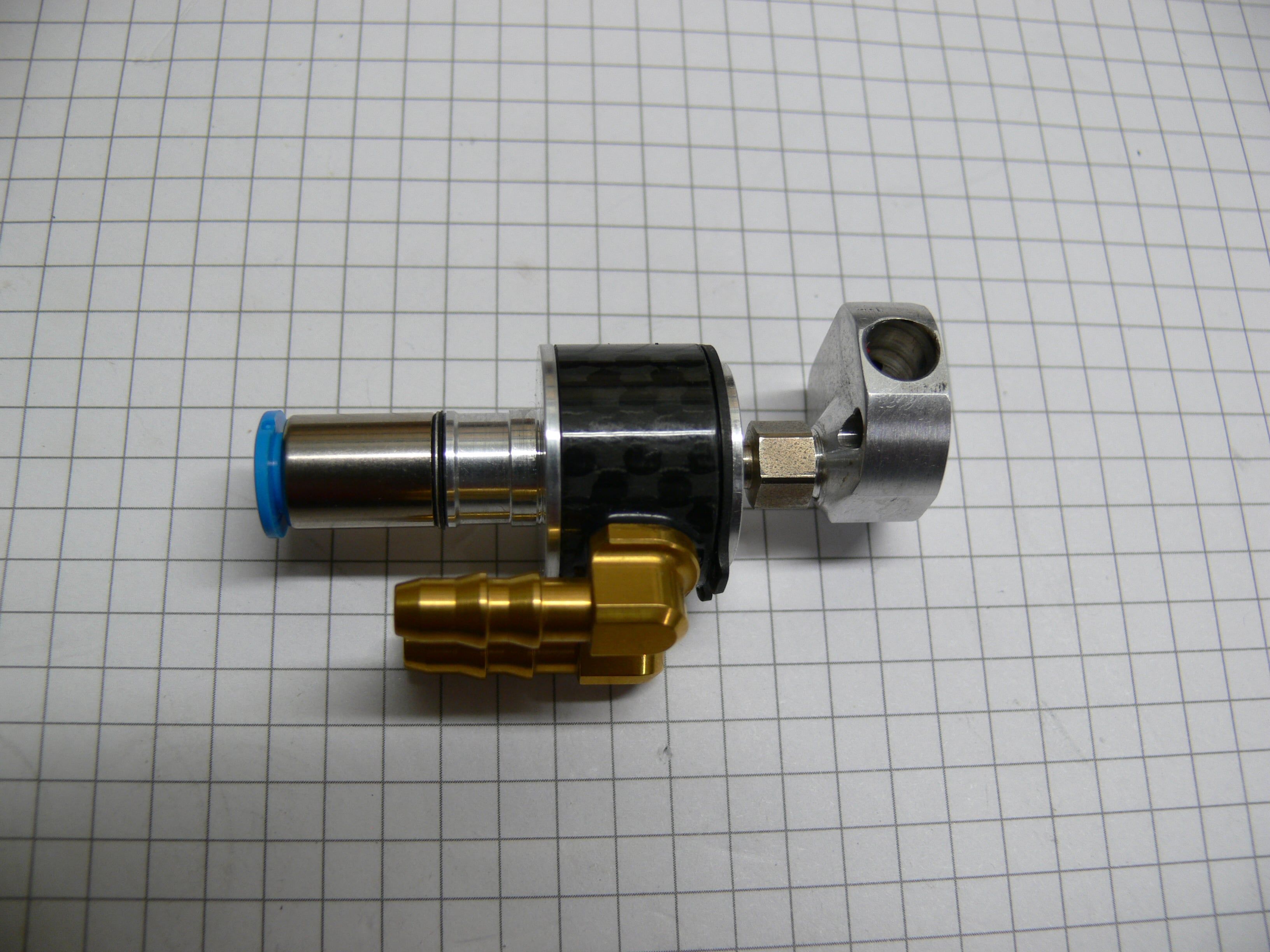

      Hello, i'd like to build up a small watercooled hotend. But i'm not sure if the heatsink is big enough for proper cooling!?
      The following picture shows my first ideas.
      The outer diameter of the (blue) heatsink is 19mm, the two fins are 1mm with a 1.5mm gap.
      The complete heatsink is only 23.5mm long .
      I have not yet defined where the water In and Out Ports will be. It is planned to make some small slots in the fins for minimal backpressure.
      Does anyone have experience with such a small heatsink in a watercooled system?
      Thanks in advance for your feedbacks.

        @cosmowave printing at PLA with a 0.4mm nozzle I have seen success with just a rubber tube around a thin wall tube as a heatsink. so its likely that a much smaller water contact surface will provide sufficient cooling, in comparison with an air-cooled hotend.

          @cosmowave You don't need fins for liquid cooling. Most of the designs you'll find on the internet are for adapting air cooled heat sinks which already have fins. But if you are starting from scratch, you don't need them. My 6 input hot end is liquid cooled so I have 6 heat breaks which happen to be PTFE lined but that's optional. So the heat breaks are simple tubes, 6m diameter which slide into a cooling block which has 6 off 6.05mm diameter holes. The coolant path is simply a couple of 5mm diameter holes which run horizontally between the vertical heat breaks, and which are connected with vertical holes forming the inlet and outlet. After multiple hours of printing, the temperature of the coolant has never yet risen above about 27 deg C and the temperature inside the part of the heat breaks that are inside the cooling block never gets above about 45 deg C.

              https://reprap.org/forum/read.php?152,824251 and in particular https://reprap.org/forum/file.php?152,file=105316 for example. Hard to imagine a smaller cold side heatsink.

                  @achrn holy sh.... this is really small and lightweight!
                  i think my design could also be a bit smaller...
                  But i'd like to keep my existing heatbreak, because it should be compatible with the air cooled system.
                  In the picture above you see, that the heatbreak is touching the pushfit. So i can't make the heatsink shorter.
                  I will thinking about to shorten the heatbreak a bit on the top side...

                          Sorry for answering to this old post. And this is only for info:
                          I have finished the work on my prototype watercooled hotend. Now it's ready to make first tests...
                          The heating block and heatbreak is from a DTO hotend.

                            @cosmowave Are those brass barbs custom or off the shelf?

                                They are more like custom. They were used as gearbox ventilation fitting in an old f1 car.
                                I have glued them in a carbon tube. They're from nitrated titanium, very light.
                                I try to reduce wheight on my effector (Delta).

                                  Wouldn't it have been better to install the two connections opposite each other and not next to each other like here ?
                                  Or are the two connections separated by a bridge so that the water has to go around the entire cooling fins ?
                                  I suspect when water pressure builds up there, the cooler water doesn't get everywhere, because water always takes the shorter route.
                                  Sorry, I changed your photo to make it clear what I mean.

                                    @norder Yes. You're right. It would be better to place the in/outlet on opposite sides. But i haven't the space for that.
                                    I don't have "bridge" between the ports. But i'm sure, the cooling will be sufficient.
