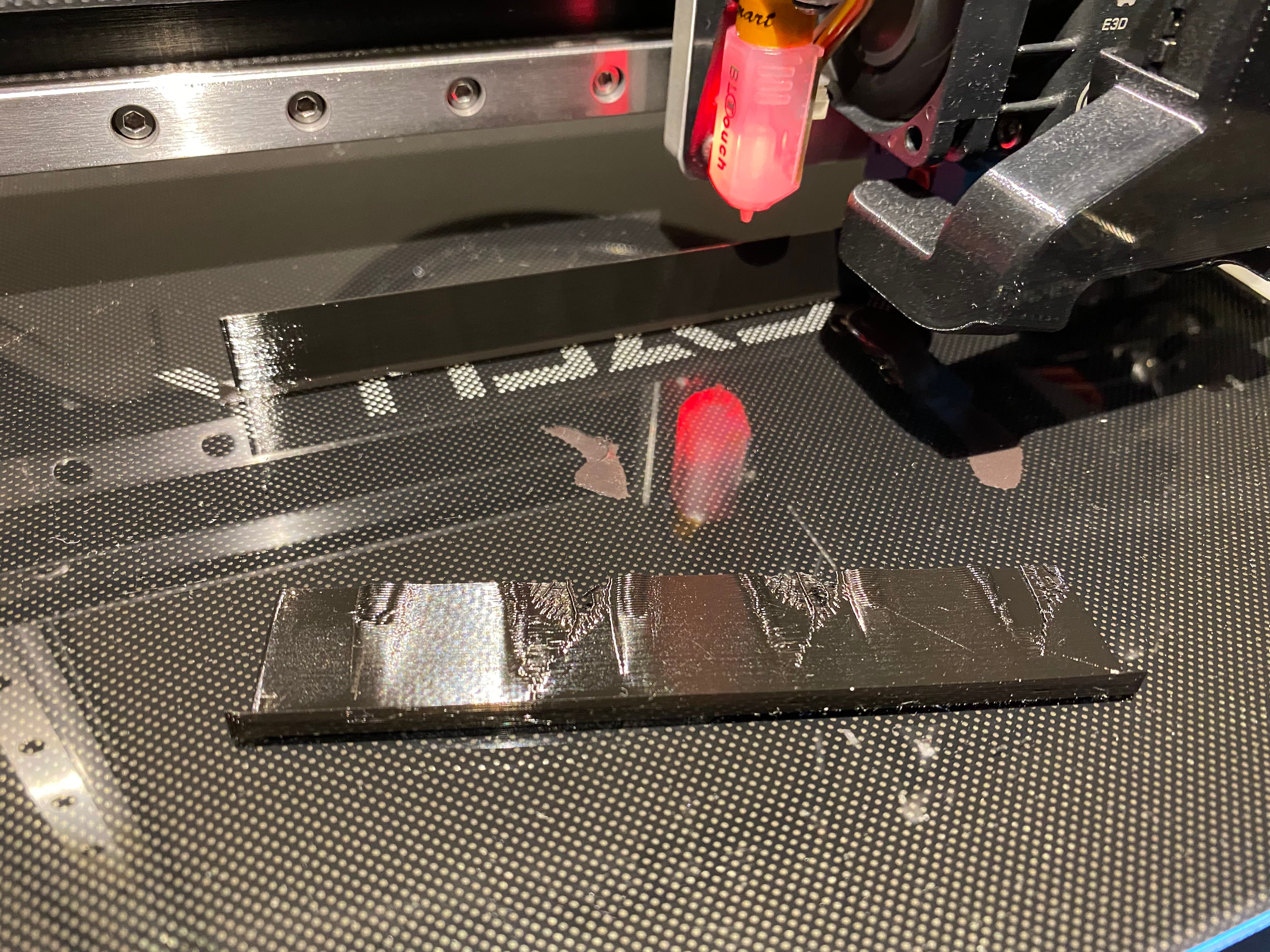

      I've created a conditional G-code macro that prints a model to help tune pressure advance. It's based on the model used in this post, which I happen to like very much. It's a fast and native solution, starts from your printer directly and requires no slicer or other software.
      The macro is a work-in-progress, but offers a lot of configurability already. I will probably make a number of improvements as I use it myself, but I wanted to share this with you at this stage for feedback and educational purposes (i.e. my education).
      I can't guarantee that this code will work properly on your machine. I have a simple cartesian model with XYZE axes. Also, I've tested this on my printer with a self-compiled post-beta 5 firmware 3.4.0, since I ran into some rounding issues in the output of earlier RRF firmwares, though this has been fixed by @dc42 and I've seen mentioned that this fix is part of the beta 6 release.
      I've kept the variable names as descriptive as possible. However, let me know if you need explanation on how to use this:

      Photo of one print in progress and one done:
      Lastly, I'm so happy with the concept and speed, that I'm now toying with the idea to make macros for:

        This is really very cool. Its awesome to see the concept of gcode meta commands used in this way. I have logged the wishlist items.
        @schmart said in Pressure advance tuning with conditional G-code:
        The code didn't look right when it contains words like "doesn't" and "haven't" in comments. This results in random "{0}" inserted and illegal G-code.
        I can't reproduce this in the latest build. I took a very cutdown version of your original macro posted with the ; doesn't comment and a few more lines and running that did not throw any errors.

                                • izemanundefined
                                  izeman
                                  I wanted to try the code as well, and it doesn't seem to work as expected. The nozzle and bed heat up, and then the heater is turned off again as it starts printing it seems.
                                  Schmartundefined 2 Replies Last reply Reply Quote 0
