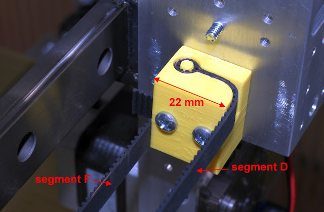

@mrehorstdmd, another one of my possibly stupid ideas with this printer is the use of a twisted belt configuration at the belt crossing. Here's the prototype I made to test the belt twist. It worked well except that the laser cut mdf bridge could not keep the pulley axles straight. I'm just getting ready to buy aluminum parts

@mikeabuilder Your motors are only engaging the belt at a 90 degree wrap. That's potentially going to let the belt slip, and is liable to be pretty noisy as the belt teeth meet the pulley. OTOH, the corners on the right wrap around the pulleys at 180 degrees. That would be a better place for the motors.
It looks like there are twists in both belts at the motor mount, and one of them is going to be in the variable length segment between the drive pulley and the X axis pulley block. That means as the X axis gets closer to the drive pulley (Y max or Ymin) the belt is going to have to twist over a shorter and shorter distance which is going to cause problems tracking on the pulleys and probably wearing the belt out quickly, among other potential problems. Belt manufacturers usually have some minimum distance spec for a 90 or 180 degree twist.
The corner pulley on the left in the belt diagram doesn't have to be in line with the drive pulley. If you move it downward in the drawing it will have plenty of clearance.
This is mine:
Notice the larger pulley on the bottom of the corner pulley block on the left. That provides extra clearance for the belt as the X axis approaches the corner pulley block. There are no twists in the belts- the pulleys (F608 bearings) are large enough (22 mm dia) that 9 teeth of the belt contact the surface even where the wrap is only 90 degrees (I saw this recommendation in some Gates whitepaper on GT2 belts).

Another whim I have is to face the teeth on the F and D (and C and E) segment towards each other, interlock the teeth and fix the belt ends as a single unit. It required the belts to be overlapped but eliminates the "one belt" concept that equalizes tension. Maybe on another iteration of the design...
