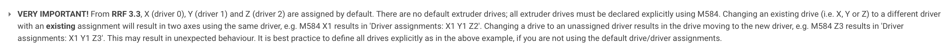

          @tecno In that case I think your M584 is in the wrong sequence as George said above try
          M584 X1 Y2 Z3 E0 assuming that the motors are connected to X Y and Z ports in that order.
          tecnoundefined 1 Reply Last reply Reply Quote 0

            Sorry but there is no reason to have X on port 1 !
            Anyhow I did that and edit config and switched motor wires = Still same problem
            Will try to switch motor wires on one winding to see if it helps.
            //edit No it did not

              Your config order of the M569 P1 to P3 suggests that the motors are connected to ports 1 2 and 3 in XYZ order tho
              Maybe reverse the order of them may solve your issue because your motors all move in the correct way when individually commanded it has to be a config issue!
              Argh sorry that order I don't think matters but I think it is still worth trying.
              Just looked up M584 and wonder if this maybe your issue.```

                      So M584 line has to be X0 Y1 Z2 and E4 or E5 or just E4 no x/y/z?

                        tecno @tecno
                        I feel like fool now 😞
                        Been looking at the carriage motion not head motion = NOOB with Delta 😉
                        All appears to move as it should.
