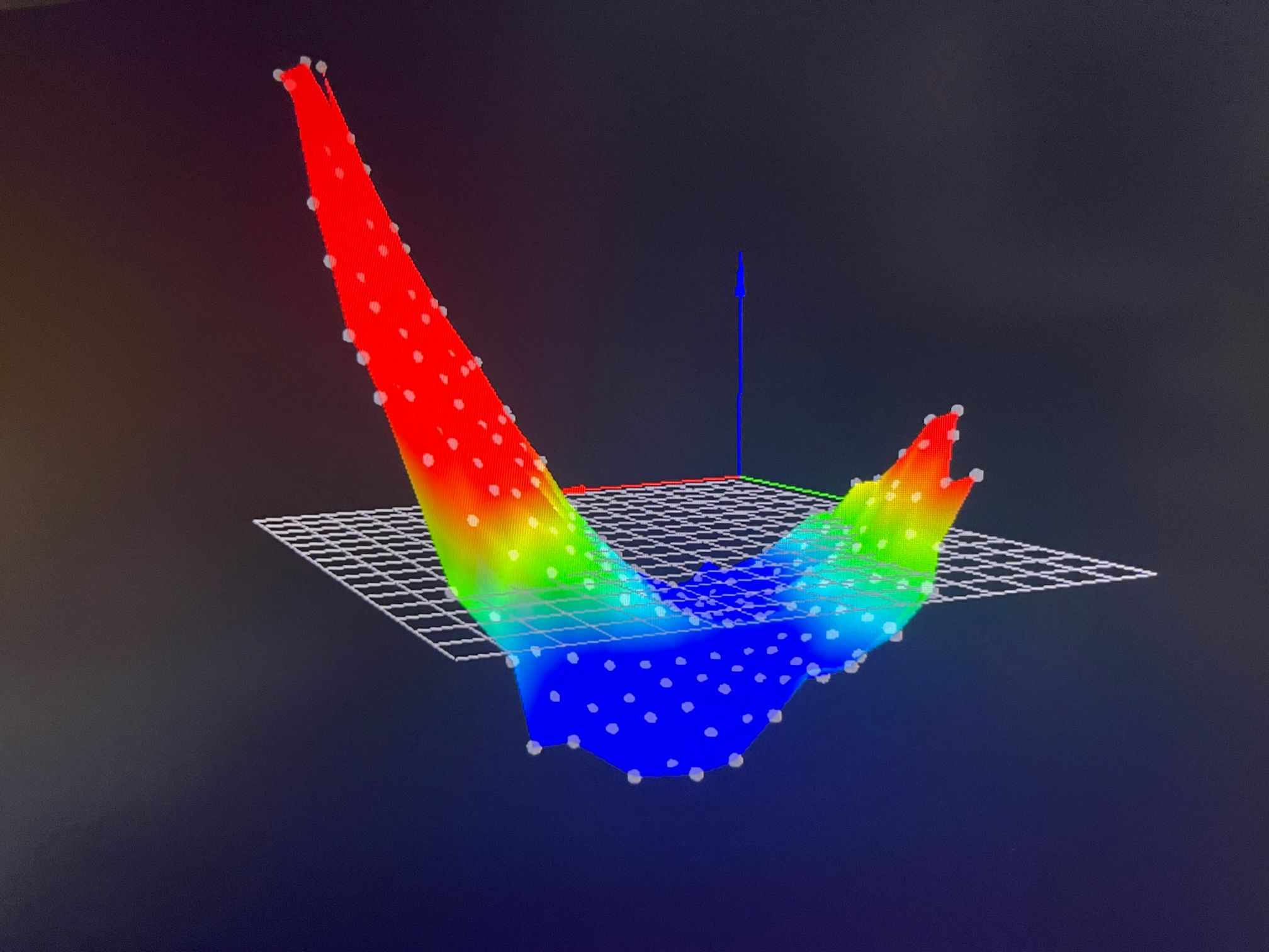

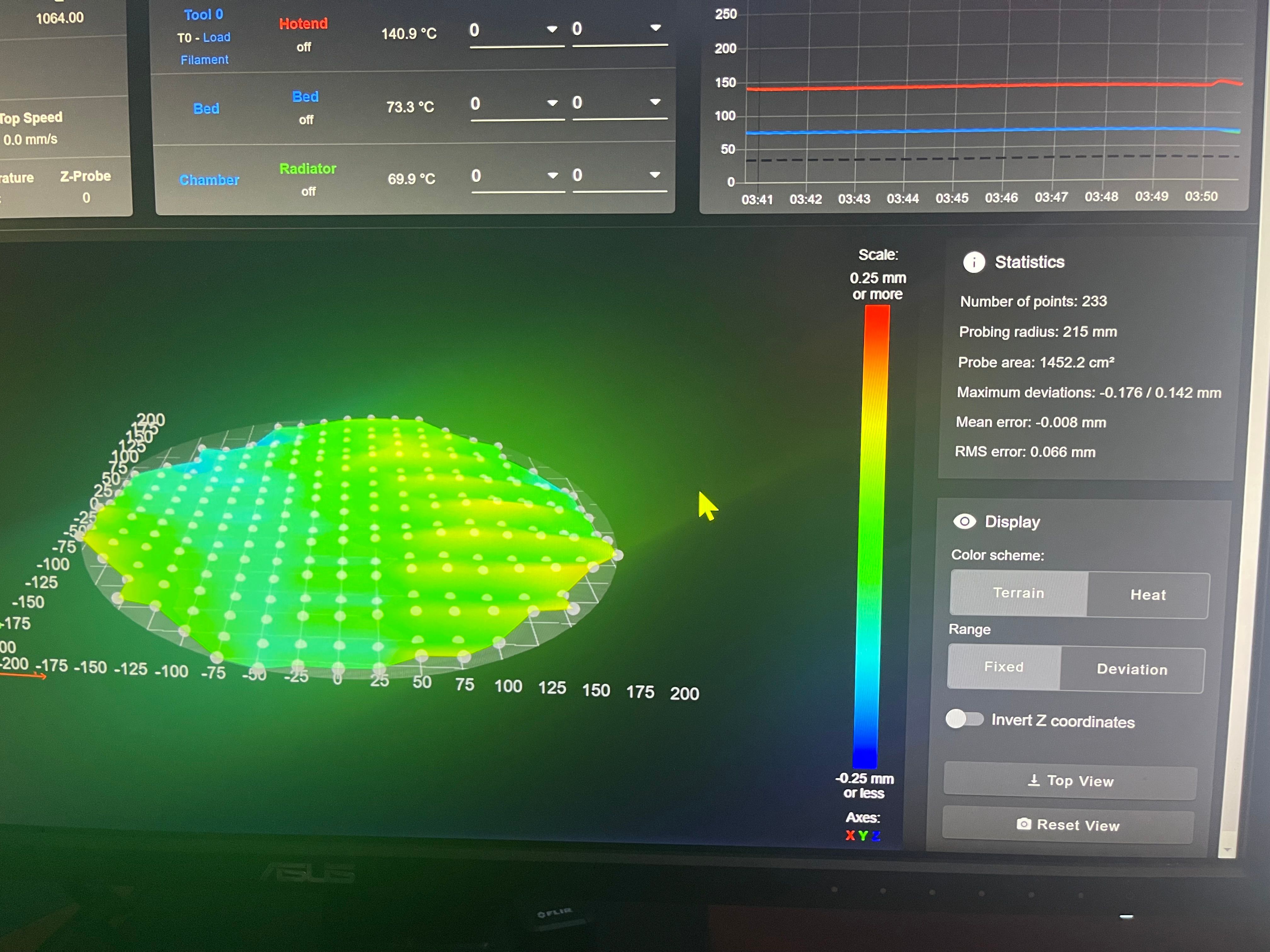

                  • patterson6undefined
                    patterson6
                    U shape height map gives small width size
                    Normal height map gives normal print size
                    So the U shape height map seems new. I still get decent first layers on both height maps. Using a 1.2 mm nozzle is prob why. I have had this printer for a while now and never really seen a map that bad. What I changed to my printer recently was the g10 bed on top of the mic6. Normally I used Printbite. Had to replace the smart effector so now I have the new version on with the small JST PH connector that I hate. I also replaced the carriages with a 3d printed design of mine. New belts.
                    The fact that the height map is every other is what's blowing my mind and I cant figure out. U shape then normal. U Shape then normal. Everything I listed above that I changed is a fixed position. Could it be the smart effector?

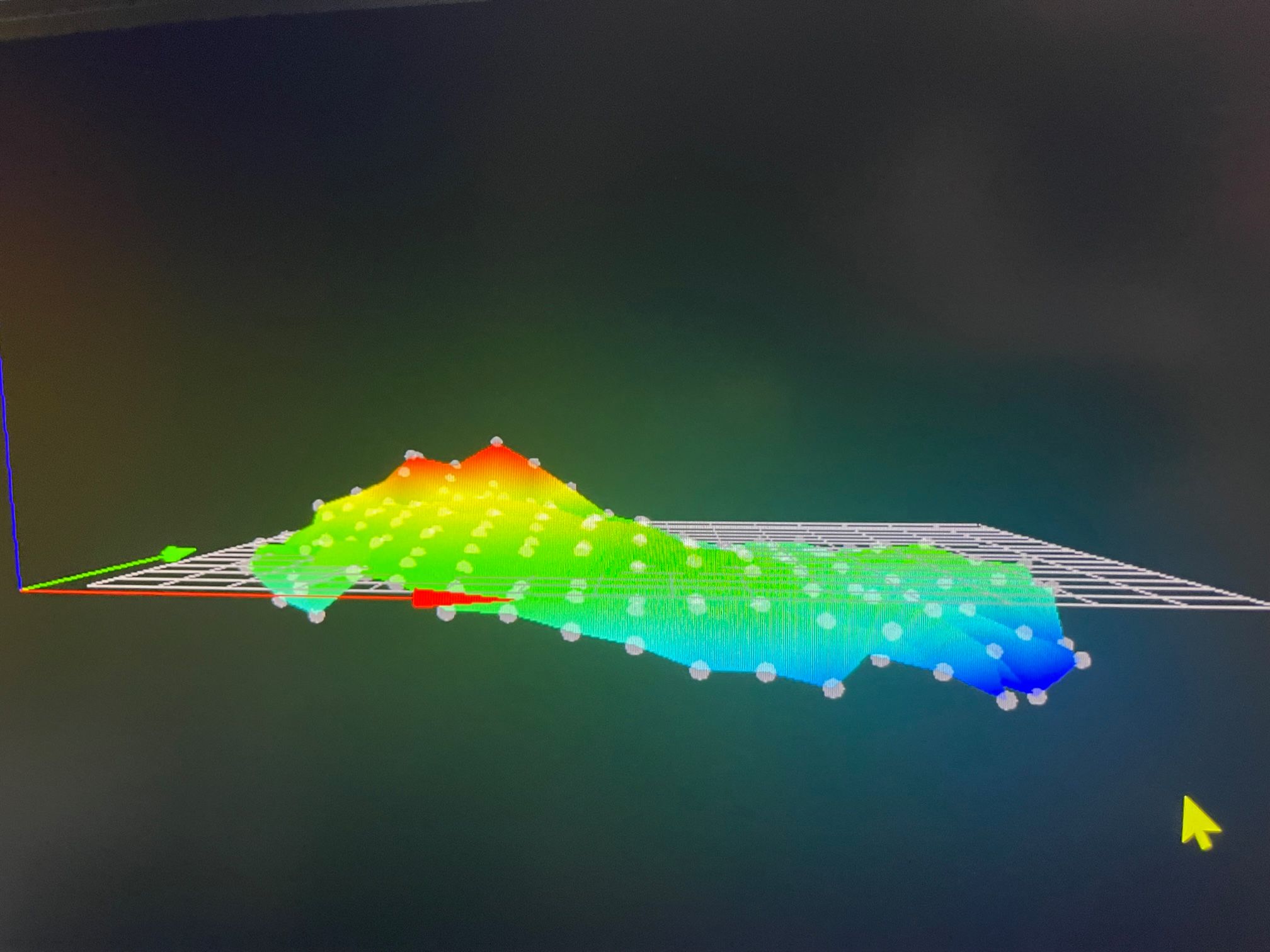

                                patterson6
                                It was the G10 bed on the mic6.... going to use 3M 468MP and tape it down see if I get better results. Thanks for the help everyone...
                                This is the height map with the mic6 and the printbite
                                o_lampeundefined 1 Reply Last reply Reply Quote 0
                                • o_lampeundefined
                                  o_lampe @patterson6
                                  @patterson6 I've had good results with a high temp magnetic sheet and a ferro-sheet between cast-aluminum and 1mm thick FR2 print surface.
                                  Makes it easier to remove prints, because the FR2 sheet really has a strong hold.
                                  I recommend doing the same with your G10, if it's thin enough to be bend...
