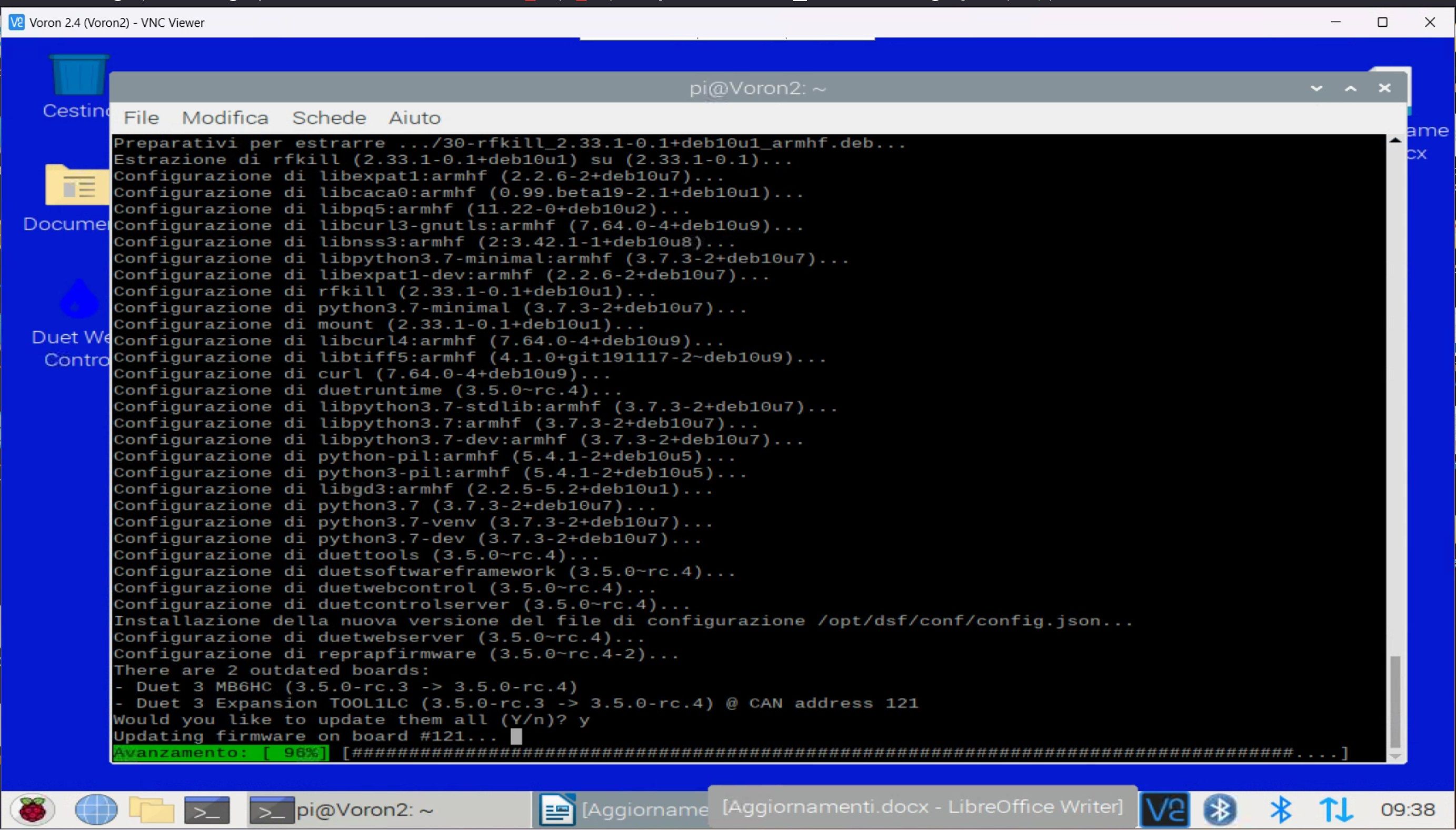

This morning I updated the printer firmware to go from 3.5 RC3 to RC4 and also the second 1LC card is now unusable.
The update process stopped at 96% (see photos). After 30 min i have reboot the printer and now M122 B121 gives no response.
Can I get warranty assistance for at least (second) toolboard? I don't want to buy a third one!!
All attempts made to unlock the first toolboard did not work.
