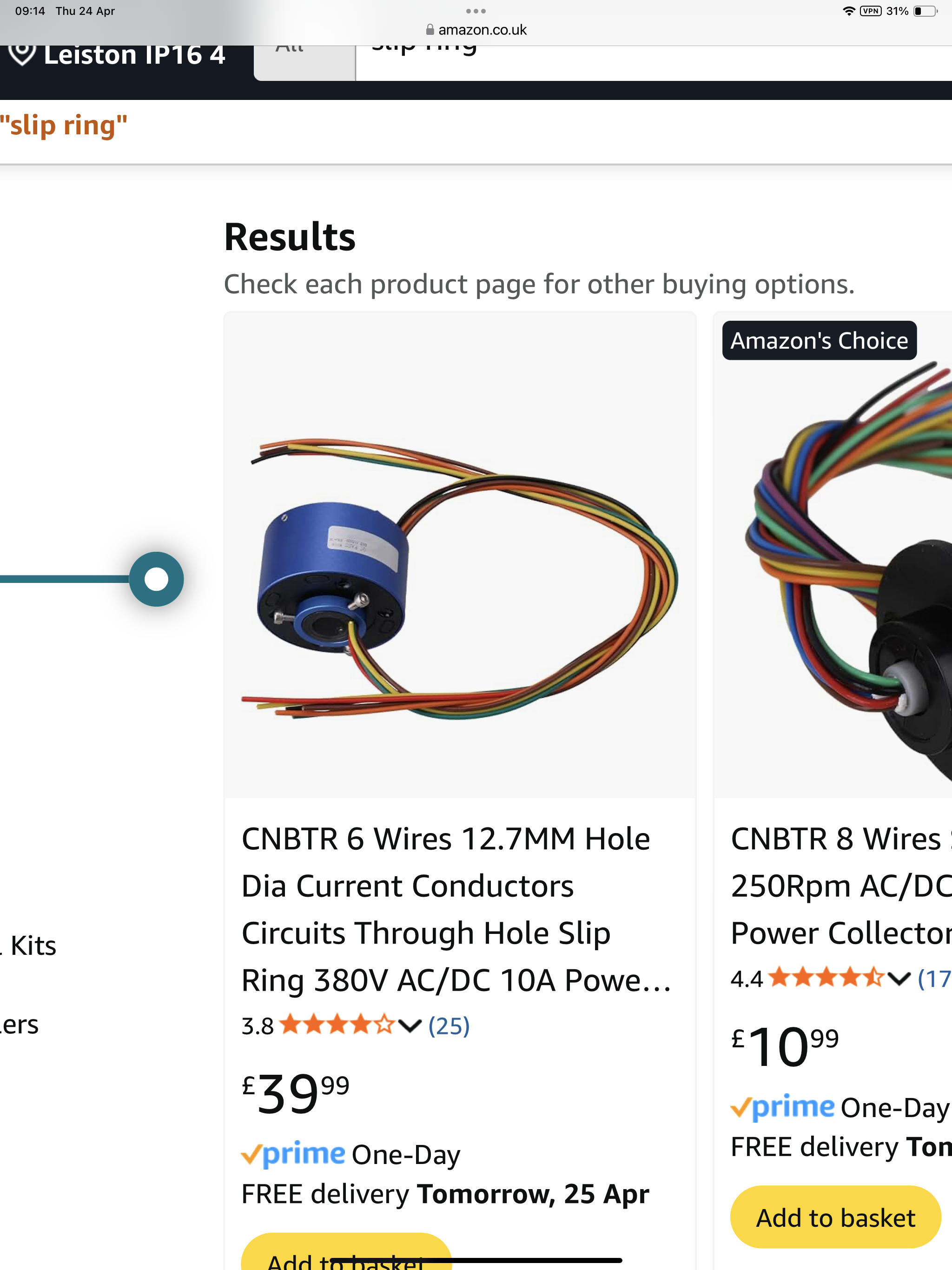

      I wouldn't use a slip ring for a heated bed. At least I wouldn't trust the Chinese specs too much.
      Maybe you can get away with it by using a 230V heater with a SSR? But that opens another rabbit hole.
      dwuk3dundefined 1 Reply Last reply Reply Quote 0
      • dwuk3dundefined
        dwuk3d @o_lampe
        @o_lampe the bed is already mains with an SSR - so I was planning on putting the SSR output through the slip ring, plus the temperature sensor.
        Are you saying that would be ok - or that I should look at a better quality slip ring?
        I suppose continuous rotation would only be a novelty feature - I wouldn't need a slip ring for 90,180,270,180,90,0 rotation - which is the main reason fir me adding it.
        So I could drop it if a good quality one is going to be massively expensive,
        I could always disconnect the cables and use a bambulab cool plate for continuous rotation demo's.
        o_lampeundefined 1 Reply Last reply Reply Quote 0

          @dwuk3d Almost forgot the thermistor....If you can, double up the lines for it, to reduce false readings from bad slip ring contacts.
          If you already use an SSR, you know the possible downsides of bang-bang bed heating. I did that for a long time and it didn't bother me.

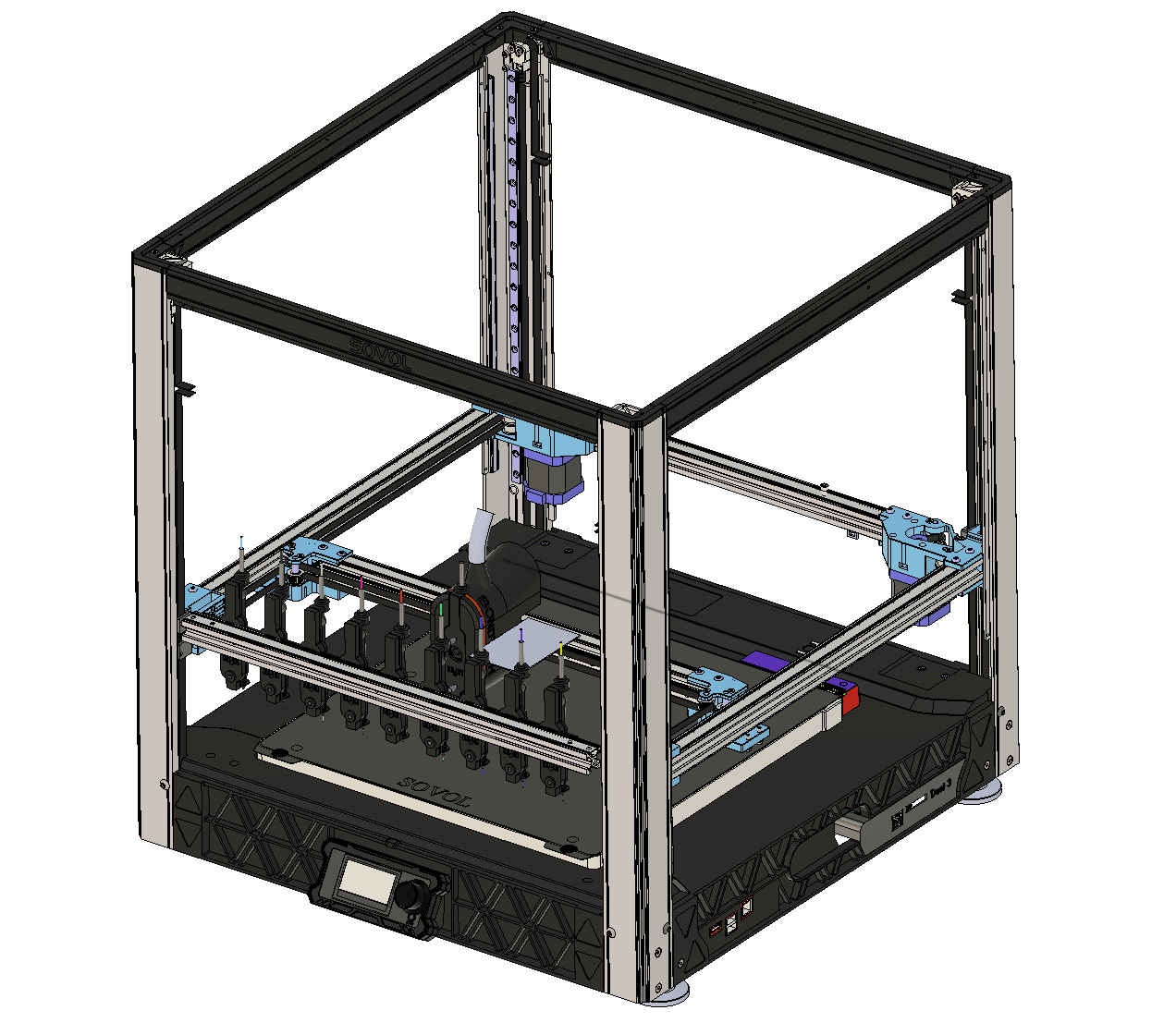

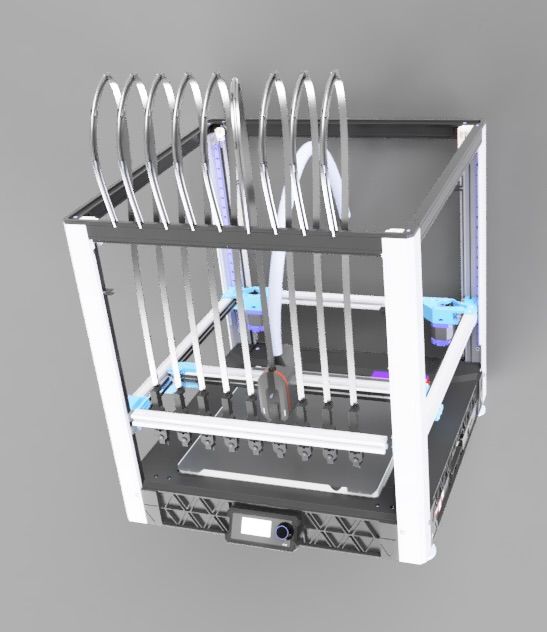

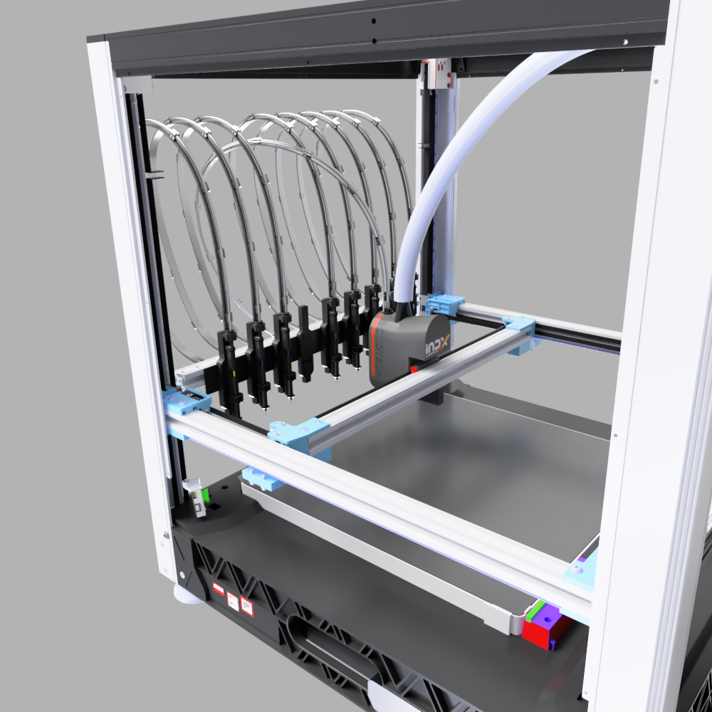

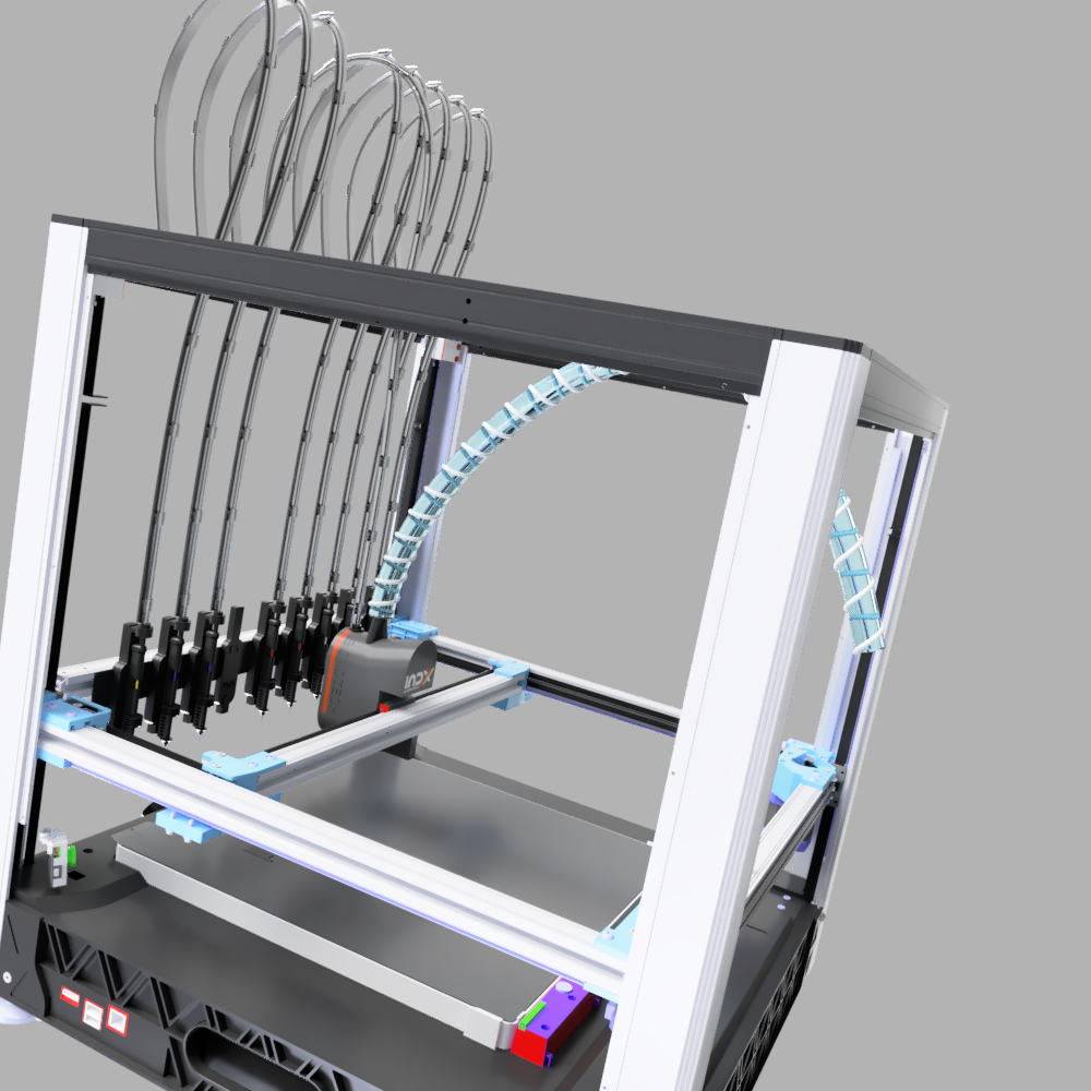

              A few more Bondtech INDX diagrams (Renders from Autodesk Fusion) - with some options of where to place the PTFEs.
              Might actually be better turning the whole thing around and having the PTFEs on the back with the head reversed on the rear gantry.
              With the front gantry having the IDEX Sovol print heads on it.
              With PTFE's starting at the front of the flying gantry.
              CDA03B31-4489-4879-BF3A-8BBB626DACF4_1_201_a.jpeg CF875C86-BF1D-4298-A19B-173E3C03E6A1.png
              with PTFE's starting at the top.
              9DAEF18E-56D5-447F-8AAD-699E75EC81B9_1_201_a.jpeg 9407EF41-89C8-43EF-8BE1-56C4B2F2D946.png 21EF63D6-B641-40F5-9F33-A75B8F99A4BB_1_201_a.jpeg 12F9DE6F-4E63-4786-9ECC-B37981A5DAFD_1_201_a.jpeg
              With improved modelling of the air pipe.

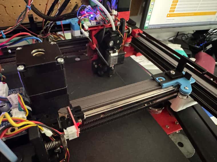

                    Started making some progress on the Trindex SV08 printer again.
                    Did some simple size test prints - and started getting issues with Z offsets.
                    I think I will have to improve my Z alignment - either by using 'voron tap' on all of the tools, or possibly using the ball probe Z offsets.
                    Plus a more serious issue.
                    When serial 3 headed printing - but with parallel print priming and colour switching between T1 (UV) and T0 (XY) - T0 consistently layer shifts about 10mm in the X and 5mm in the Y - and the layer shift if quite fast.
                    I had this issue a while ago and thought it was related to the Z hopper - but I have turned the Z hopping off on XY and are still getting the issue.
                    If I do similar prints with T2 (WV) and T0 (XY) - both of them print fairly well.
                    I have seen some oddities in normal alignment testing with X and Y sometimes jumping when I switch between tools - so not sure if it is an issue with my config, macros, slicer GCODE or a 3.5.4 problem.
                    Will continue investigating to try and get the problem to occur in a more simple gcode file without parallel printing.
                    Or might just try setting up another tool - T3 - and assign that to the UV - to see if I get the same issues.

                        @o_lampe thanks - do you mean G92's.
                        I don't think I have any of those in my macros that would be invoked mid print - the problem occurs mid layer 2 = when the printing switches back between T1 to T0. But I will check.
                        I think though that something is changing the endstop offsets for the Y and Y axis and then jumping them quickly to the new position.
                        I have noticed some unexpected behaviour when moving around between tools and mapped axis - but haven't really found a way to recreate the issue.
                        If I don't manage to resolve the problem I suppose I could try removing the X and Y mapping completely from the T1 and T2 tools definitions , and instead post process the G0-G3's to specify U,V & W instead when using T1 or T2.
                        Ps - the sequence is
                        Homing.z offsets
                        Motion system 1 - layer 1 - print T0 section ok
                        Motion system 0 - layer 1 - wait for pre-heat, delay, preheat, T1 print prime, wait for print T0 to finish, T1 print layer 1, move Z up to layer 2, T1 print layer 2.
                        Motion system 1 - layer 2 - wait for pre-heat, delay, preheat, T0 prime for layer 2, wait for T1 to finish, T0 head jumps to incorrect position, T0 print layer 2 - with layer shift

                                        dwuk3d
                                        Front extruder now rebuilt with Nema11.
                                        Had to cut some of the shaft off, and I think I can bring the motor down about another 13mm if I cut more of the shaft off.
                                        All heads now being on Nema11's should now enable proper Z hopping and (with the aid of a post processor) some independent Mesh adjustment.
                                        Also moved the front extruder off of sensorless homing on to Optical End stops.
                                        With the X and B (Z Hopper) Axis sharing a single sensor.
                                        Did find one tiny issue - I accidentally used the wrong filename homeb.g instead of homex.g when I was creating my new optical end stop file - I had previously renamed the homex.g to homex_sensorless.g
                                        Instead of telling me the homeb.g file already existed I think it just wiped it out - so I had to recreate it from scratch.
                                        Also - when switching endstops between different Axis I am finding that in order to release an end stop from the old Axis and need to give it another one - so I am using one of the unused io[x].in from one of the boards to swap that into the old axis end stop - so that it releases the end stop - so that I can assign it to the new Axis.
                                        Not sure if this is the best way to do it - especially as I am gradually using more and more of the io[x].in's for things.
                                          dc42 administrators @dwuk3d
                                          @dwuk3d said in Sovol SV08 Multiple Motion System Upgrade.:
                                          Just set the endstop position to 'none' in M574, e.g. M574 X0 will release the IO input that was previously used by the X endstop.
