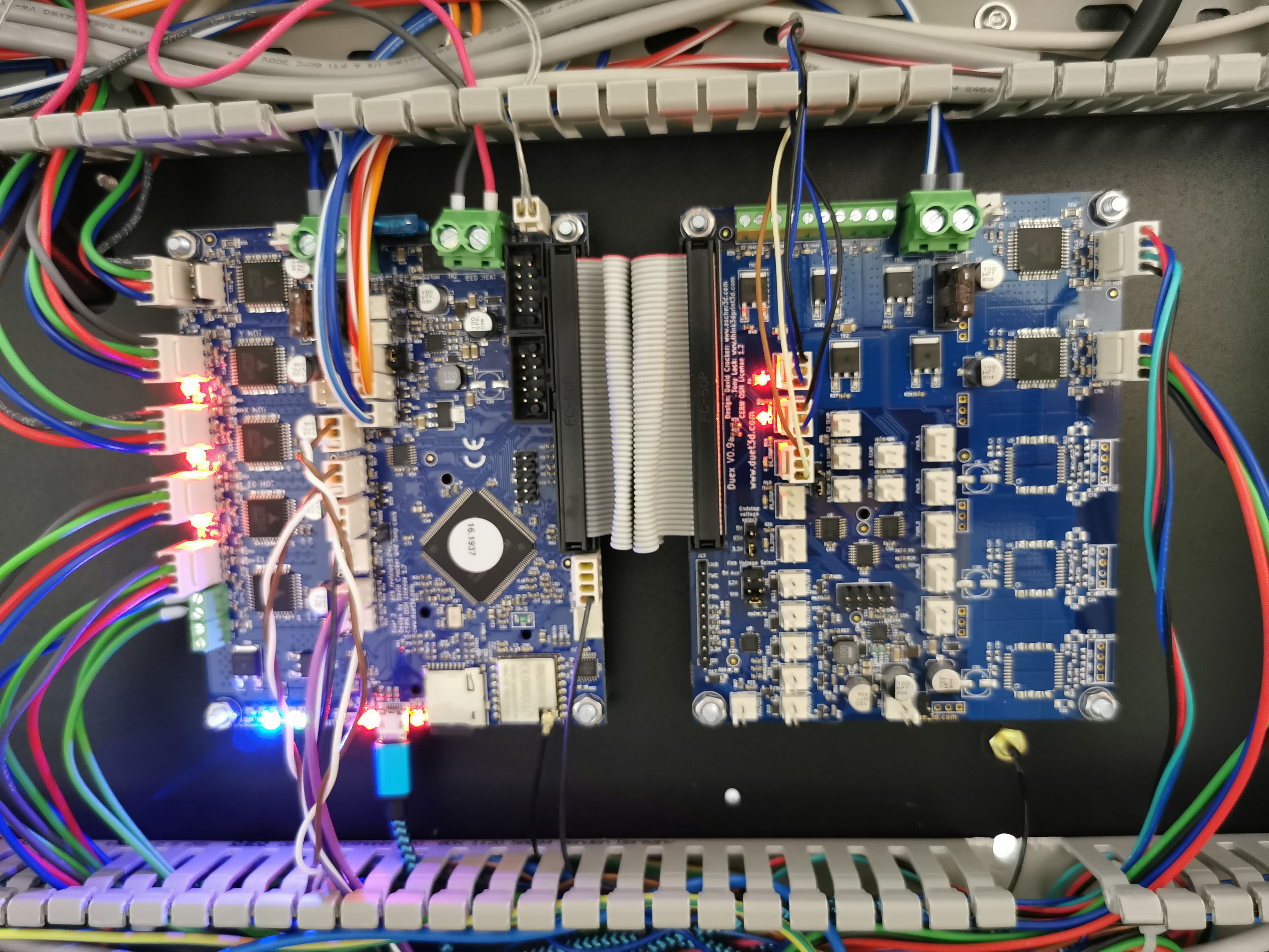

      Hi Community,
      i have a strange problem. With a standard setting of mine with a duet wifi and DUEX 2, I get the error message:
      Error: short-to-ground reported by driver (s) 7 8 9
      Error: over temperature shutdown reported by driver (s) 7 8 9
      but since it is a DUEX 2, these drivers are not available.
      How can this error message come about?
      The firmware is also stable at 2.05.1
      here the wiring:
      The Duex is also supplied with 24V.
      The Setup works normally, everything works! There ist just the error-message...
      Thank you in advance
      Christian (CR-3D)

        post your config
        also does your wire conform with ?
        https://duet3d.dozuki.com/Wiki/Duex2_and_Duex5_Features#Section_Wiring

          Yes you can see the double wire clamp at the duet wifi...
          here the config:
          Notice, this config works identically at other printers too ...

            try adding
            M569 P7 R-1
            M569 P8 R-1
            M569 P9 R-1
            however i would suggest that you update to 3.1.1
            M350 X16 Y16:16 Z16:16:16 E16 I1 ; Configure microstepping with interpolation
            M92 X80 Y80:80 Z1600:1600:1600 E409 ; Set steps per mm
            M566 X400 Y400:400 Z50:50:50 E500 ; Set maximum instantaneous speed changes (mm/min)
            M203 X50000 Y50000:50000 Z800:800:800 E12000; Set maximum speeds (mm/min)
            M201 X900 Y900:900 Z1000:1000:1000 E1200; Set accelerations (mm/s^2)
            you can only define multiple values for E not Y and Z
            these should be removed

              Looks like it is showing as a Duex5 instead of a Duex2?

                CR3D @Veti
                @Veti said in Duet-Wifi + Duex2 - short-to-ground reported by driver(s) 7 8 9:
                M569 P7 R-1
                M569 P8 R-1
                M569 P9 R-1
                I tested this and it works! Thank you! πŸ™‚
                I also changed the multiple settings for the Y and Z axis, this was no problem till yet -> but it is better to make it clean πŸ™‚
                @sebkritikel
                You are right too! There is a DueX5 listet... I donΒ΄t know why ...

                  Is this a new Duex2? When and where did you purchase it? It showing up as a duex5 is odd.
                  Can you try reflashing your firmware? Staying with 2.05.1 is fine.
                    Phaedrux Moderator @CR3D
                    @CR3D I've been told this is likely caused by a bad connection underneath the SX1509b chip, which would certainly qualify for a warranty replacement.

                      @Phaedrux ok thank you for this Information! πŸ™‚ i will contact Roland πŸ™‚
