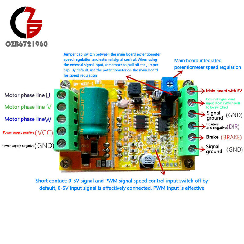

    wondering how I am supposed to connect this to a fan output for PWM control on a Duet2wifi + duex5
    so here is what I plan on doing.
    Connect the GND on the controller to main GND on the board.
    Connect the VCC on the controller to the 24V PSU (this thing runs on 9-60V).
    put JUMPER across the "JUMPER INT 5V EN pins".
    connect the EXTERNAL SIGNAL INPUT (PWM) on the controller to the FANx (+) pin.
    connect the signal GND on the controller to the FANx(-) pin.
    connect the main board 5Vinput on the controller to a 24-5V step down voltage regulator that can supply the required Amperage (30mA). or perhaps an always on FAN input on the duet2
    I have a Duex5 and I have 24V fans that I run with my hotend thermostatically. Do I just keep the JUMPER on the VIN on the "V Fan jumper select"?
    undefined undefined undefined 3 Replies Last reply 8 May 2021, 00:16 Reply Quote 0

      I would connect signal ground on the BLDC board to the Duet ground.
      Then, connect a 4.7 K Ohm resistor from FAN- to FAN+ and connect FAN- to the PWM input on the BLDC board. This should produce a signal on FAN- that goes from 0 Volts to whatever you have your fans set to. Which should be set to 5 Volts.
      I would also just connect the BLDC 5 Volt input to a 5 Volt output on the Duet, but of course you need to make sure the current required by the BLDC board is not more than the current available on the Duet 5 Volt signal.

        @tekstyle it would be simpler to connect ground, +5V and INPUT to one of the five PWM outputs of the DueX. I am assuming that you are not using all five heater outputs on the DueX, because the PWM outputs share control signals with those heaters.

          Does it really need a negative voltage on the DIR pin? I always get nervous, reading those chinglish descriptions. Especially when my expensive Duet board is at risk.
          Cant you try it with a cheaper Arduino board first?
          • undefined
            @o_lampe said in connecting a BLDC controller to duet2:
            I don't think so, I think it means positive and negative motor direction.
            undefined 1 Reply Last reply 8 May 2021, 07:12 Reply Quote 0

                I have a CPAP blower I plan to use as a remote parts cooler. what is the point of a 4.7K ohm resistor across the Fan- and Fan+ ports? to me, it seems like it would just short it out but I am no electrical guru. Looking at the board, I thought the "external signal PWM 5V input must be from a (+) source" so I am confused why you would connect the Fan- to it.
                undefined undefined 2 Replies Last reply 8 May 2021, 08:40 Reply Quote 0

                  The 4.7k is a pullup resistor. The fan- pin isn't actually connected to GND, but switched to GND with a FET.

                    i think i figured it out.
                    the main 5V is actually an output. for this application, it is useless.
                    if brake and/or direction is connected to ground, it will stop the impeller and switch from CW to CCW direction respectively.
                    signal gnd needs to be on the same 5V circuit as PWM (+). the signal gnd pin and the main GND pin are connected internally. i do not think it draws a lot of current here. basically, if there is 0-5V across external signal PWM pin and signal gnd, the motor turns on.
                    I got this thing working to power my blower on the breadboard. so the only pins in question now are just the PWM (0-5V) and signal GND pins to the duet. the fan port would do just fine I think. I plan on using up all my heater channels.
                    undefined 1 Reply Last reply 8 May 2021, 08:52 Reply Quote 0

                        I'd be careful with the brake. We don't know if there are flyback diodes on the controller. If not, braking the motor can feed voltage spikes back into the power supply. (and Vin of the Duet)

                          I did an initial test and the fan port does turn it on. however, it turns on the blower even when the fan is set to 0 on DWC. i changed the frequency to 0 from 500. currently my config.g is M950 F0 c"fan0" Q0. it still wants to turn on at full power. is this where the 4.7K ohm resistor comes in?
                          I checked the fan pin with a DMM. when fan is set to 0% in DWC, voltage is around .6V. When set to anything but 0%, i see it pulse from .6 to 4.5V .
                          I am not sure why it is doing this when it tested fine on the breadboard. on the breadboard, a supply of 2V would spin slower than a supply of 3.3V.

                                @tekstyle why don't you follow the advice I gave in my first reply in this thread?
                                undefined 1 Reply Last reply 10 May 2021, 20:08 Reply Quote 0
                                • undefined
                                  tekstyle @dc42
                                  i just did what you recommended. works great. i didn't earlier because i needed a heater port but i just remembered i configured a fan port as a heater output to an external SSR in the past which works fine so now I just do that with a second fan port. thanks David.
