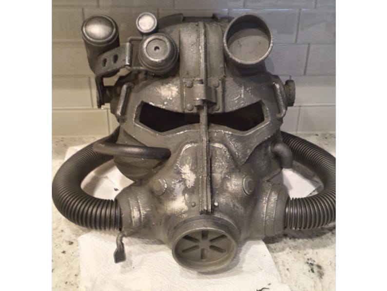

    • RE: best post processing method to get smooth prints
      @tas good idea to put metal powder in the epoxy. that will give at least a realistic surface if one goes more for a cast iron look.
      and yes just layering something over the print instead of sanding and bondo seems more realistic to me.

    • best post processing method to get smooth prints
      I got a request to print a cosplay helmet for someone, but I dont want to sand PLA, or bondo such complex structures.
      Im familar with the polysmooth system and im thinking about building a bigger polysher --> [filament2print.com]
      but i wonder if there isnt a generally accepted better way or maybe a new material that i havent heard of that sands better than PLA?
      Cheers F
