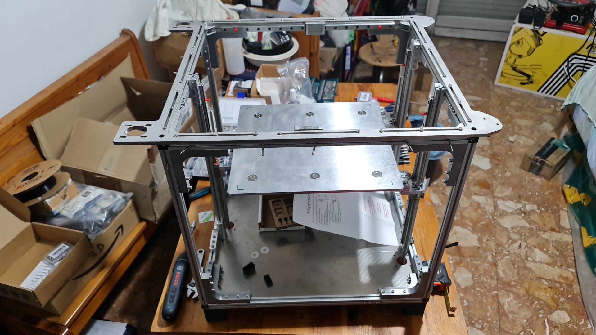

    • Tevo Little Monster + DuetWiFi + Touch7" (my conversion)
      This version of the printer is quite old. Now of the original printer remain just the glass and the top bottom frame (and parts of the skates).
      Substantially the original printer had too much tolerances and imperfections that make the tool unusable.
      Rebuilt everything with new and more qualitative part now it work.
      look also 3 post below for the rest of the description !!!
      This will take some time to explain with photos (i must still produce some of them) and descriptions... So for now I open the 3d.
      I'll use this post as reminder for me, to do not forget all the steps I made and , maybe , it will be useful for other adventurer decide to puts ends on a such big delta printer.
      1st and important... The Tevo company is terrible. I mean the back office for sure. In particular Kelly Zheng took 3 month for NOT send what she promised (and I paid). Paypal cover the funny joke.
      2nd... the printer for became something close an accurate tool need lots of work and money to put in.

      List of upgrade and modifications....
      Hardware:
      1. DuetWiFi + Duet LCD 7" (last firmware stable) + heat sink (with thermal pad T412) on parts could became hot.
      2. Nema motors 0.9 (for 3 motors + extruder) + dumpers + 4 12v noctua 6cm for cooling with lamptron fan hub (with resistance for lower the fan speed)
      3. Extruder (Bondtech)
      4. Original D3D Hotend + Volcano extension + copper nozzle (Nickel coated) + silicon cover.
      5. Original BLTouch v2
      6. Belts with iron core
      7. Full enclosure
      8. End filament guide/sensor
      9. Custom Borosilicate glass (41,5cm X 5mm) + adapters block (i'll provide the STL)
      10. Cartridge modified for better precision and less torque.
      11. Starting for the hot chamber solution... Double plexiglass (aluminum + double plexiglass + pvc + .... ) .

      7)As I started with the intention of build ABS parts i read about the necessity of build an enclosure for keep the worm.
      I used some aluminum bar . For the big windows I used 3mm plexiglass and for the smaller window I used the PVC material. All those parts , with the relative screw and rubbers are available in common DIY stores.
      For the small windows I tried to use the plexy but it crack for vibration and torsion.
      now with the black panels is more cool ^_^.
      For the closing mechanism I used dome adhesive magnet.
      I have done some holes on the top and bottom frame for block the corners that sustain the enclosure.
